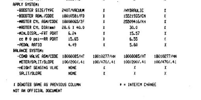

The brake pedal assembly is also from an 87. So I would think it should play nice with the 87 master.
This is correct.
The design intent pedal ratio for the ZF/BD combo is 4.49:1.
You can check this on your truck by measuring from the brake pedal pad to the pivot point, and dividing that by the distance from the brake pedal pin to the pivot point.

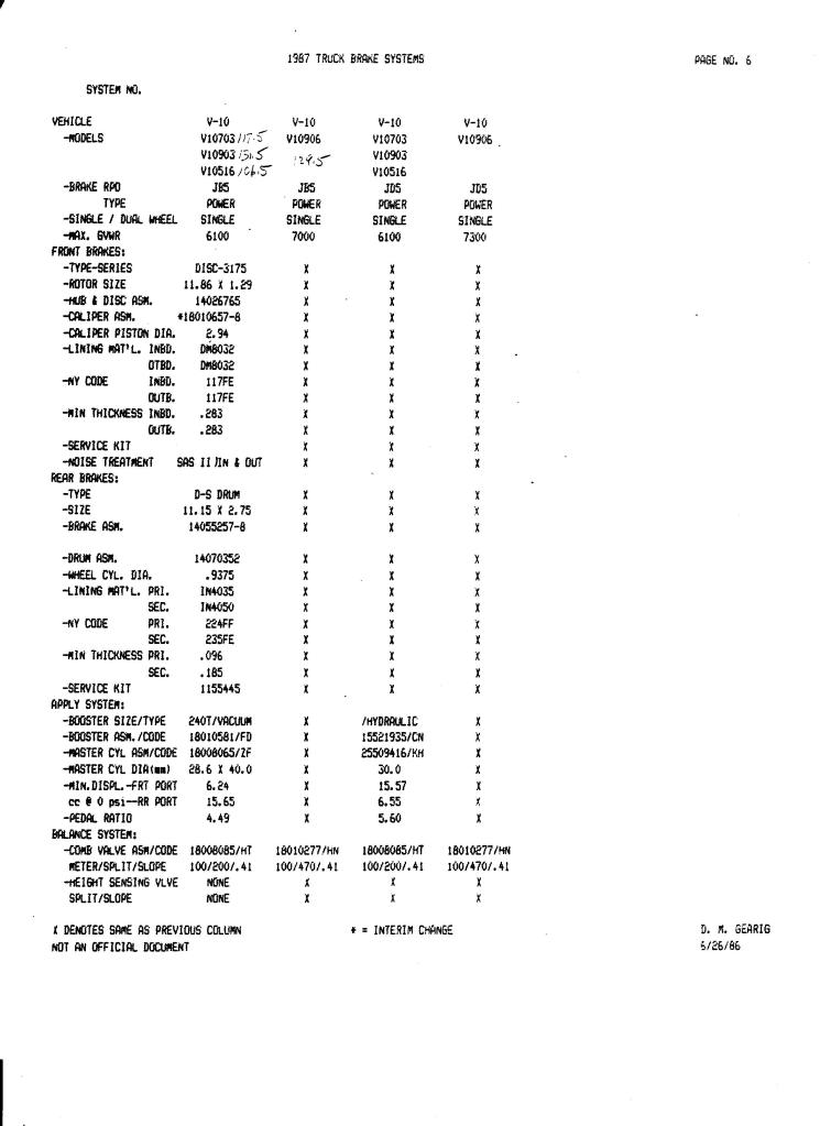

I knew I had this but couldn't find it -
Here is the brake system release chart for 1987 R series trucks. These are the charts the design engineers would create and refer to when releasing the system for production and service.
K

As per Keith's document, your ZF master cylinder was used with the common 4.49:1 pedal ratio. The higher pedal ratios are used with manual brakes (6.50:1) or hydroboost (5.60:1) and would cause your system to have a "grabby pedal, due to too much leverage -- just the opposite of the problem you're having.
Looks like the M/Cs had either a 1" bore (25.4 mm) for manual brakes or 1-1/8" (28.6 mm) for non-hydro power brakes. So your ZF master should work with your FD booster and a 4.49 pedal ratio. Yes, there is also a CM booster/ZF master combo, but since there are no booster specs, I can't tell the difference between the CF and FD boosters. Could be a larger diameter diaphragm on the FD booster.
Anyway, assuming you have a 4.45 pedal ratio, you have the booster and master cylinder shown in the 4th column of Keith's document. Looks like JB5, but so is the one in the next column. ???
Also, have you checked the booster by sucking on the hose?
And I think the suggestion to bench bleed the master is a good one. I typically do it installed on the truck. It's less messy and just as effective, if not more so. All you need is a helper to pump the pedal. I'd bet $1 that you'll get some air bubbles!
Finally, don't forget the rear brakes. Make sure the full arc of the shoes contact the drums. New shoes on turned drums makes for contact only in on the center part of the shoes, thanks to the death of "brake shoe arcing" machines.
