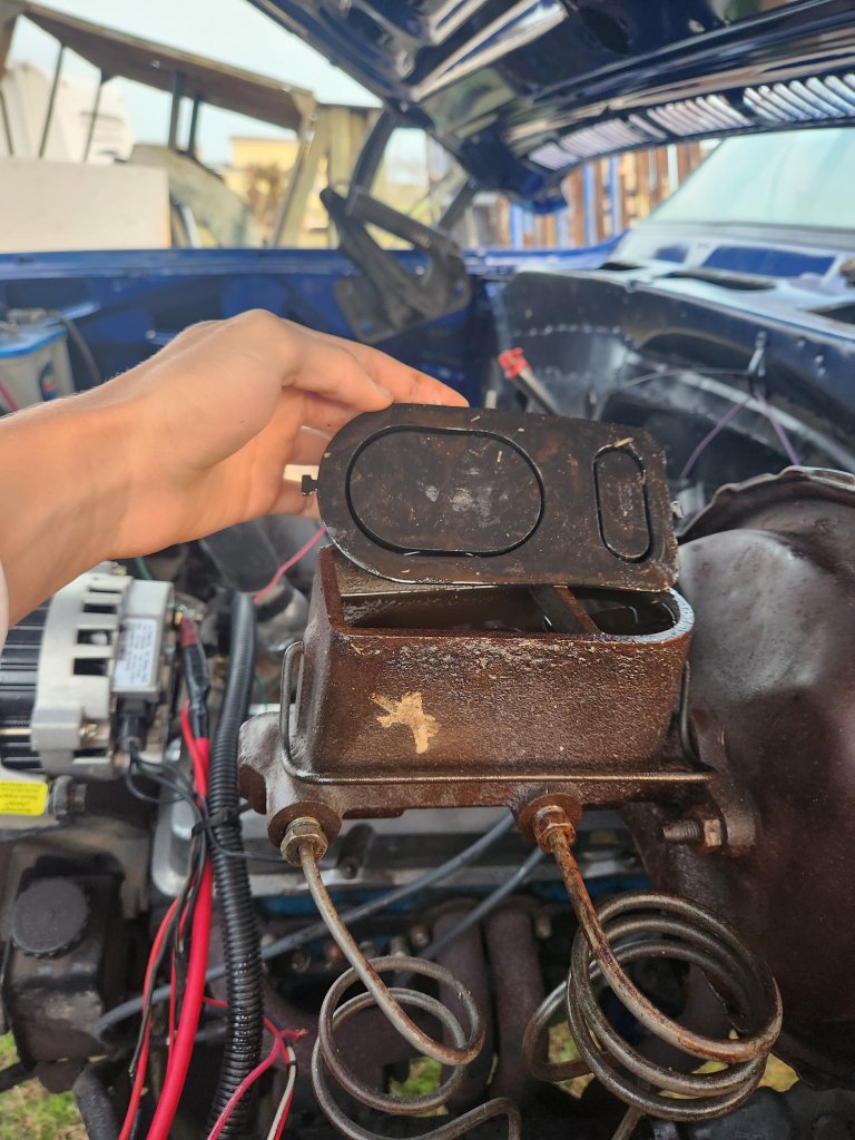

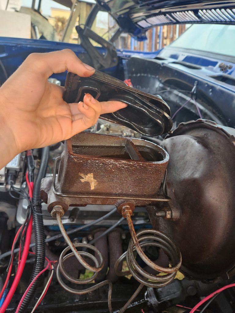

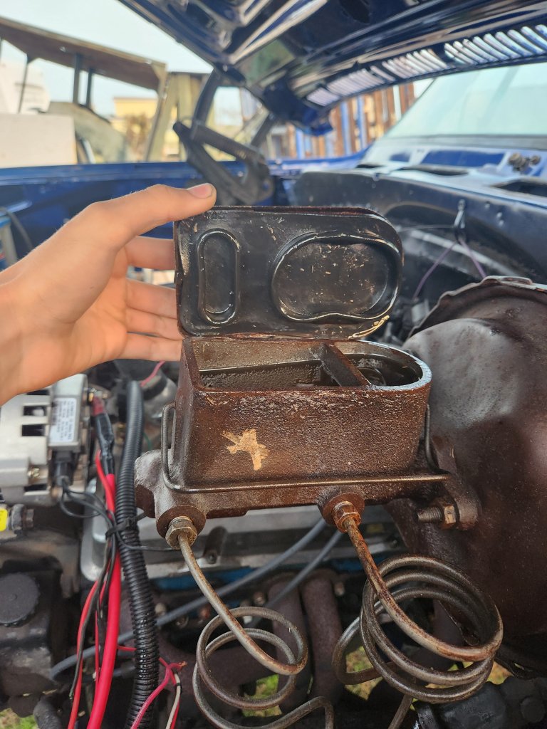

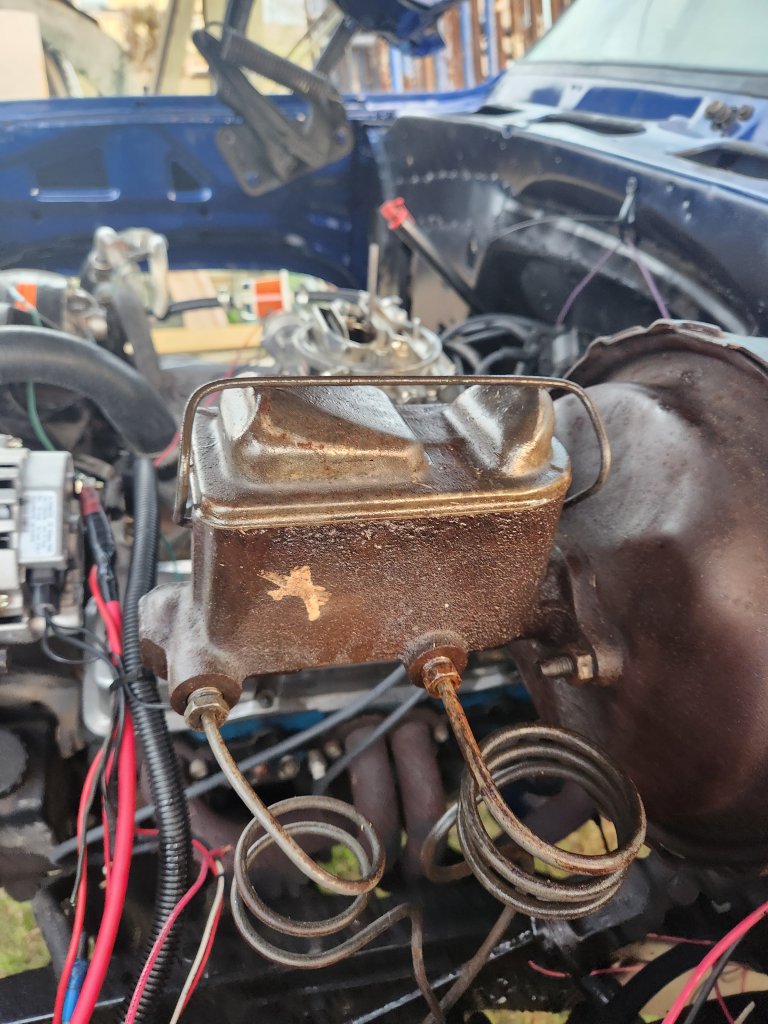

Odd question... brakes are ... sub optimal. But good enough to drive while being carefull.
But the rubber seal on my master is on backwards. It actually seems to be the wrong one. I can't seem to find the correct one however. Could this be part of my issue?
(I've got a replacement mc coming in in a few weeks just need this working so I can drive around for a while)
Not your problem. Just holds fluid in. Someone probably swapped caps. Or gaskets and put the wrong one in. The cap is right.
Okay cool
I'll just keep some fluid on me while I drive. It leaks out the back a bit but I do have it overfilled.
