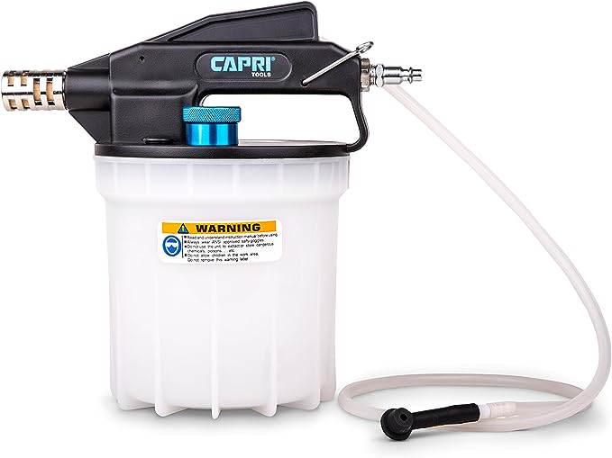

Do your self a favor and get a Vacuum brake bleeder. Capri makes a nice one (CP21029) and Amazon has knockoff brands starting $30. Easy to use and you can flush your whole system solo, just stop every so often and top off master cylinder.
