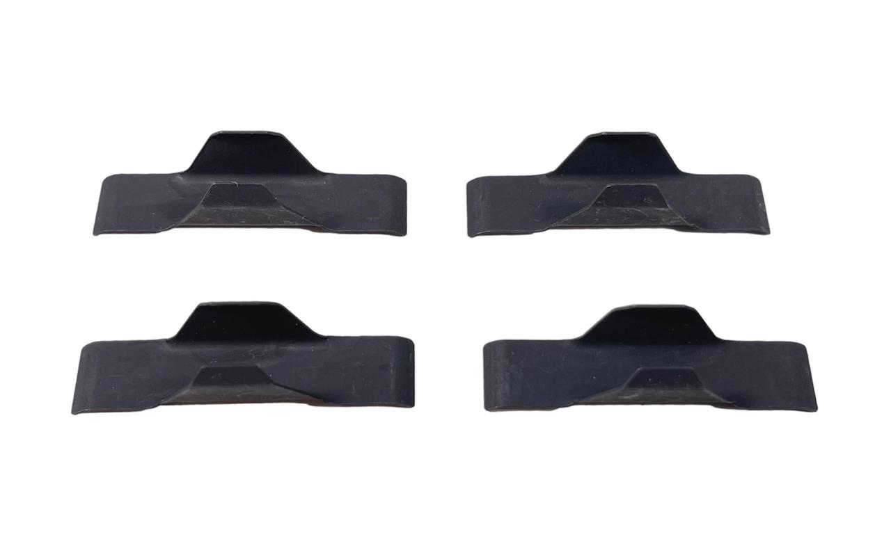

Ours had four holes, metal clips. One lined up with the star adjuster. I saw them on rock a uto yesterday.

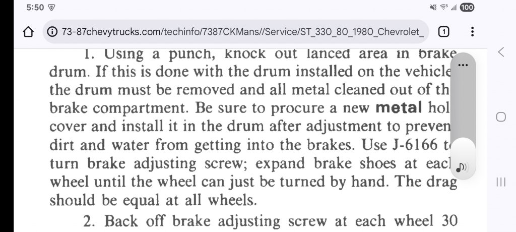

Just wasn’t sure if drums would melt a rubber plug or not, as the service manual clearly says use metal plugs.
