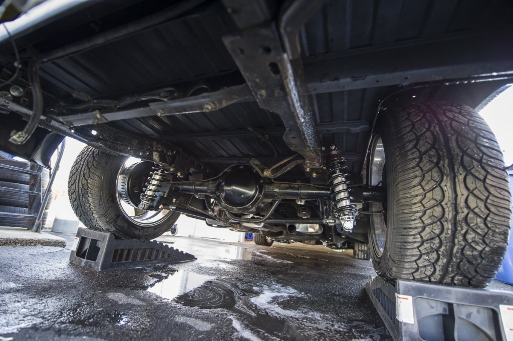

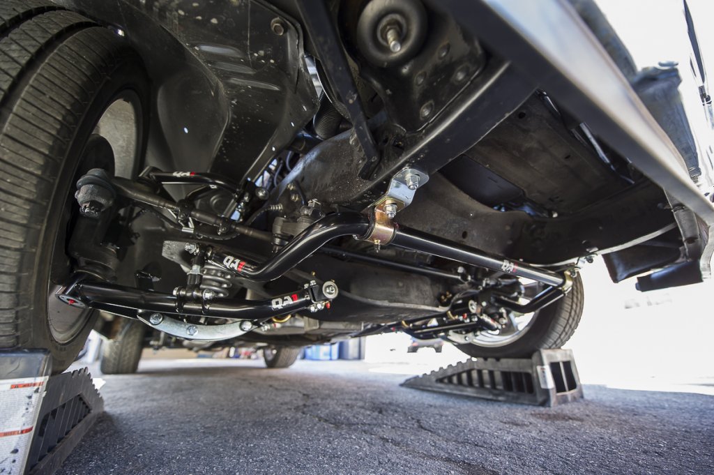

You will probably have to strip it down to the bare frame and re-locate all the fuel lines, brake lines etc...Just a thought. Maybe a suspension modification will be more effective.
don't want all the frame done...just a few critical point.....suspension is done! :)

I really like the QA1 set-up. If it was on the market and available 2 years ago, I'd probably would have gone that route.
I also liked Ridetech, CPP truck arm rear, and considered a few full frames but was concerned about hauling/trailering light loads and staying on budget for my son.
