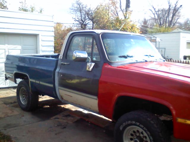

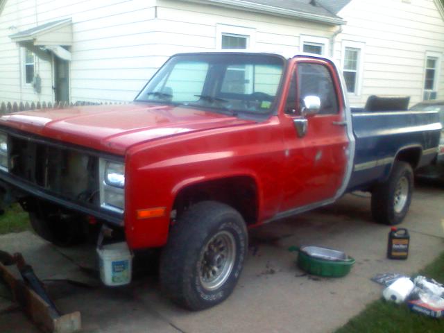

in these pics you can see my problem. the passanger side is pretty much ok.. lol the driver side is off.. help?
Swims350
4,361
833
Logan WV
none
rear cab mount area is damaged or the bushing is worn out. maybe even the floor support on that side. As for the PS looks like the fender up front just needs raised up.
