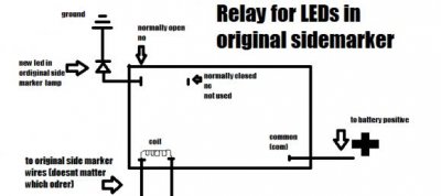

oh yea!!! got the leds in the sidemarkers to work EXACTLY as if from the factory. turns out using relays was the best option. i made up a diagram to show how.

I'll have to study this but GOOD JOB!!!! :High 5:
