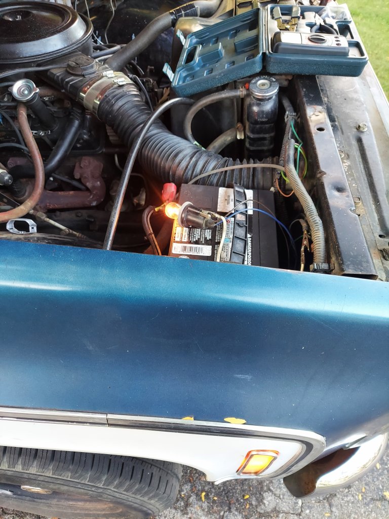

My apologies, I did not receive your notifications to my post. I found my problem and my problem was I had a bad ground on the passenger side turn signal. To make it puzzling it was inside the connection was broken and found out when I pulled it out. I checked wiring and I had continuity but did not check the voltage, nor thinking the ground wire was not making full connection into the socket. I took a pic of my troubleshooting so you can see what I had to do to make the lights work. After I pulled my jumper wire and adjusted the remaining tab inside the turn signal socket I plugged her in and now they work. Repaired in place.

You may have a ground problem like what I had. Check your ground (black wire) connection inside your right turn signal. It controls both turn signal and side marker illumination headlights on. If you have voltage there you know you got a bad ground.
