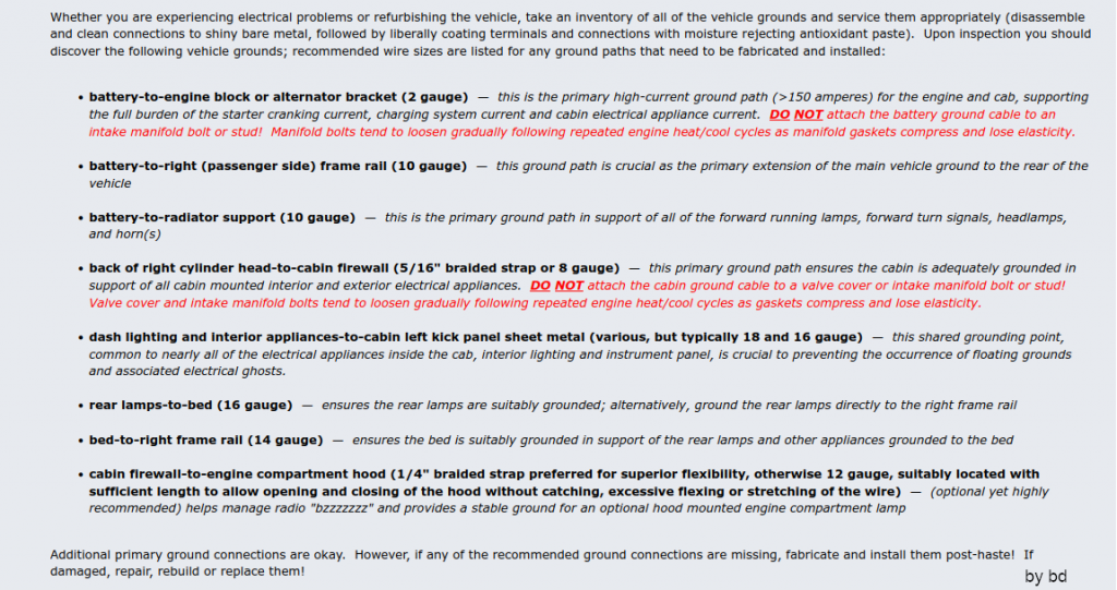

I agree with the other folks that are saying to check your grounds. It may be worth checking the dash ground bus which is behind the cluster/above the parking brake. I had a single wire break on mine and it cause some crazy behavior from the lights and blinkers.
