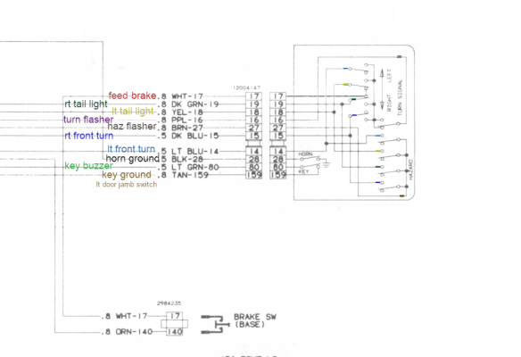

Check for power on the WHITE wire at the turn signal switch connector while pushing the brake pedal. If you have power on the white wire, check for power on the yellow and green wires, while pushing the brake. If you have power on those, the problem is somewhere between the turn signal connector and the rear of the truck. If you have no power, replace the turn signal switch.

The turn signal switch supplies power to the green & yellow wires running to your brake lights. The power can come from one of three wires. White - for brakes. Purple- turn signal, or Brown - hazards. So, since none of those work, it is likely a turn signal switch problem or both the green (right) & yellow (left) wires running to brakes lights are the problem- disconnected/not making connection from turn signal switch to brake lights for some reason. same as what @Matt69olds pointed out
