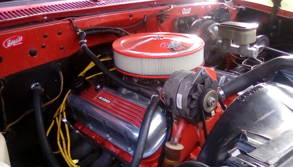

Welcome from Ohio. I have a 76 454 block, .060 over with Skip White 496 rotating assembly. 781 heads. Holley 750. 10.6-1 compression. Very happy torque monster!

How was the quality of the skip white rotating assembly?
I’m thinking about going with the std stroke +.060” over kit from them
very happy. Been in the truck about 7 years now
