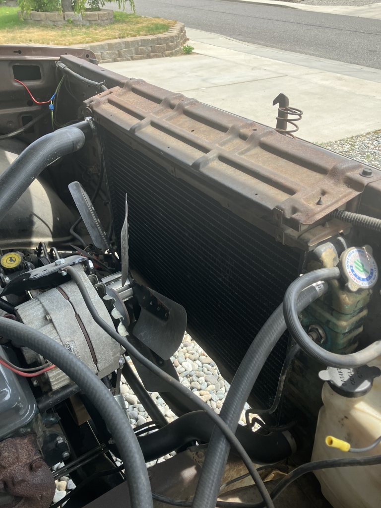

I just looked at your fan Pic. Get that off of there,and replace it with a factory fan,and fan clutch. Or get your electric fans but those flex fans with no clutch,have a reputation for coming apart and hurting people and damaging hoods. IDK how much real risk there is,I won't run a setup like that. I do know that they aren't as efficient as your factory fan and clutch were.
I was shown that at a young age and never had a flex fan since.
