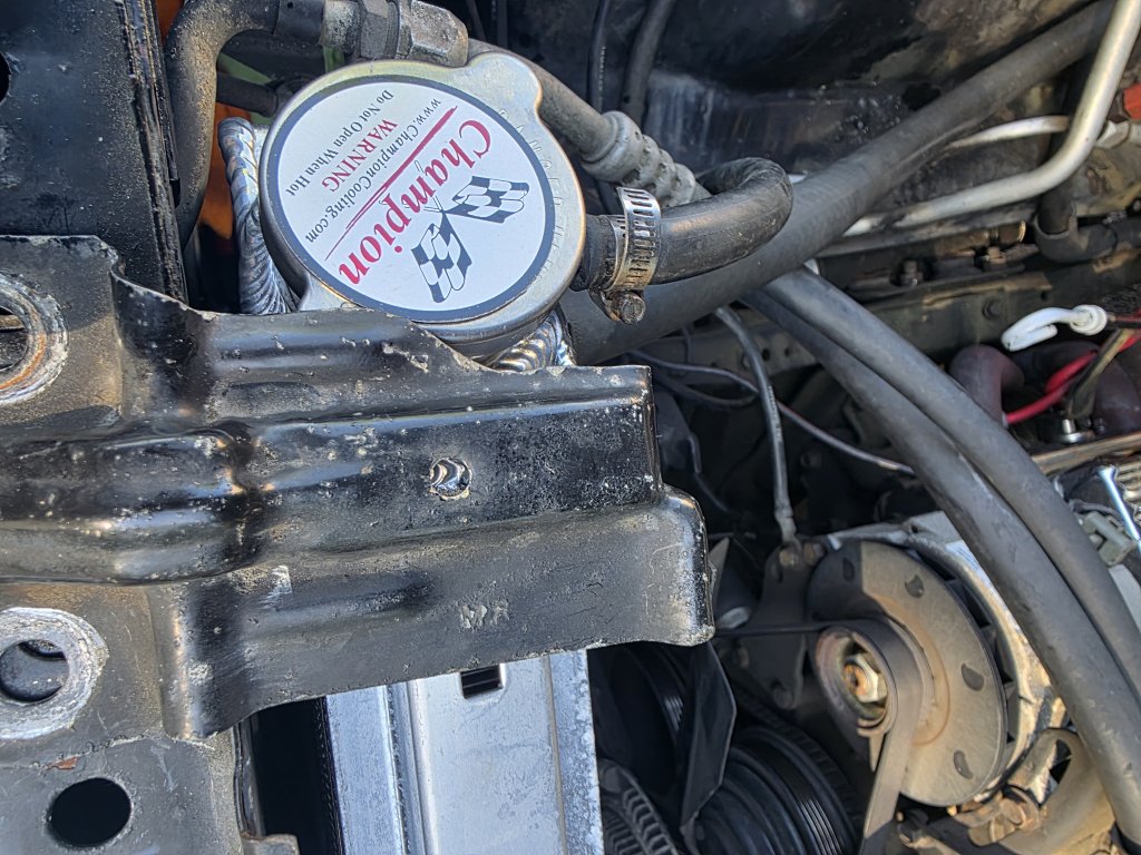

I bought a champion aluminum radiator from champion and they said it would fit my 1987 Chevrolet R10, but it doesn't. The top metal hold down brackets don't line up and the fill cap get covered by the metal hold down. Tried to go through their return policy and got ghosted. Thought i had more photos, but must have deleted them.

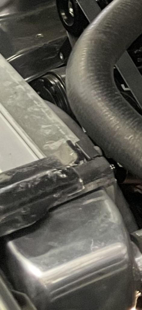

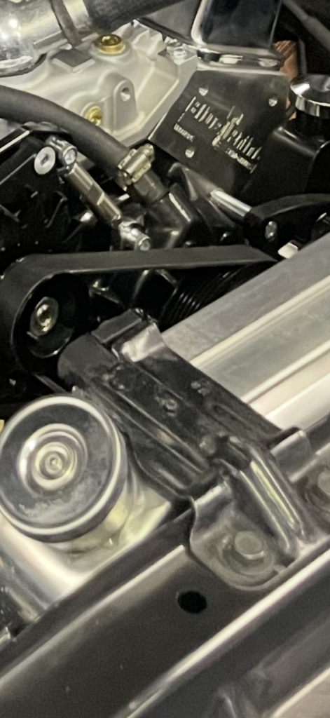

I bought a Cold Case radiator for my ‘83 K5. I had to heavily modify the upper metal mounts to hold the radiator and upper fan shroud in place.

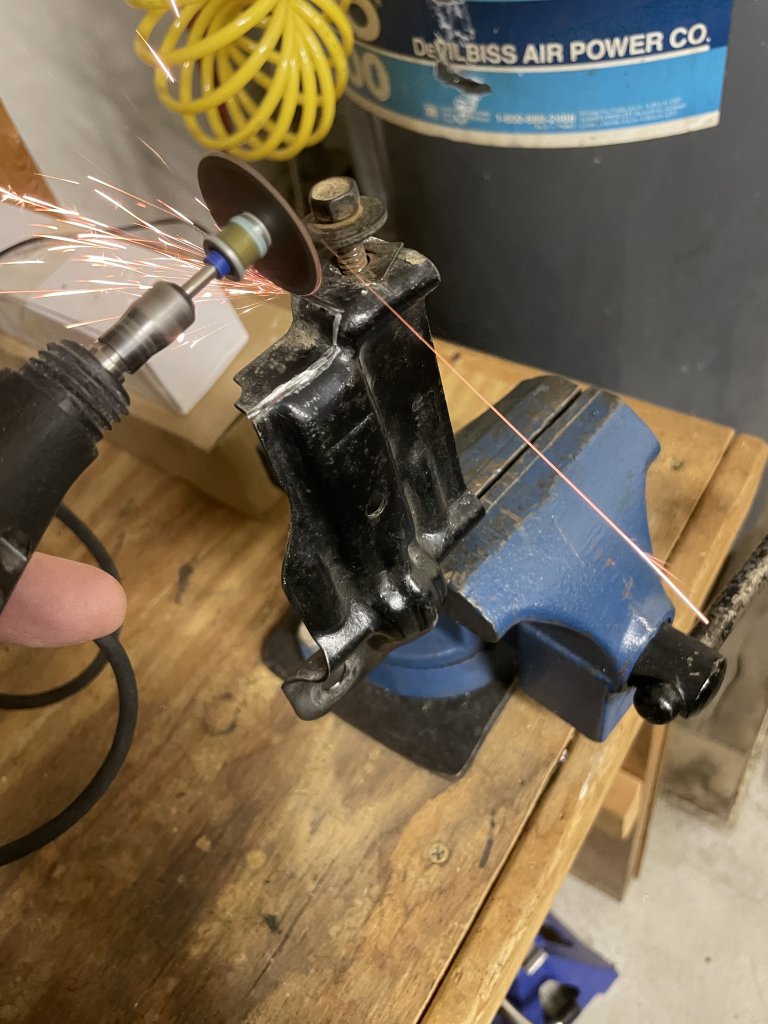

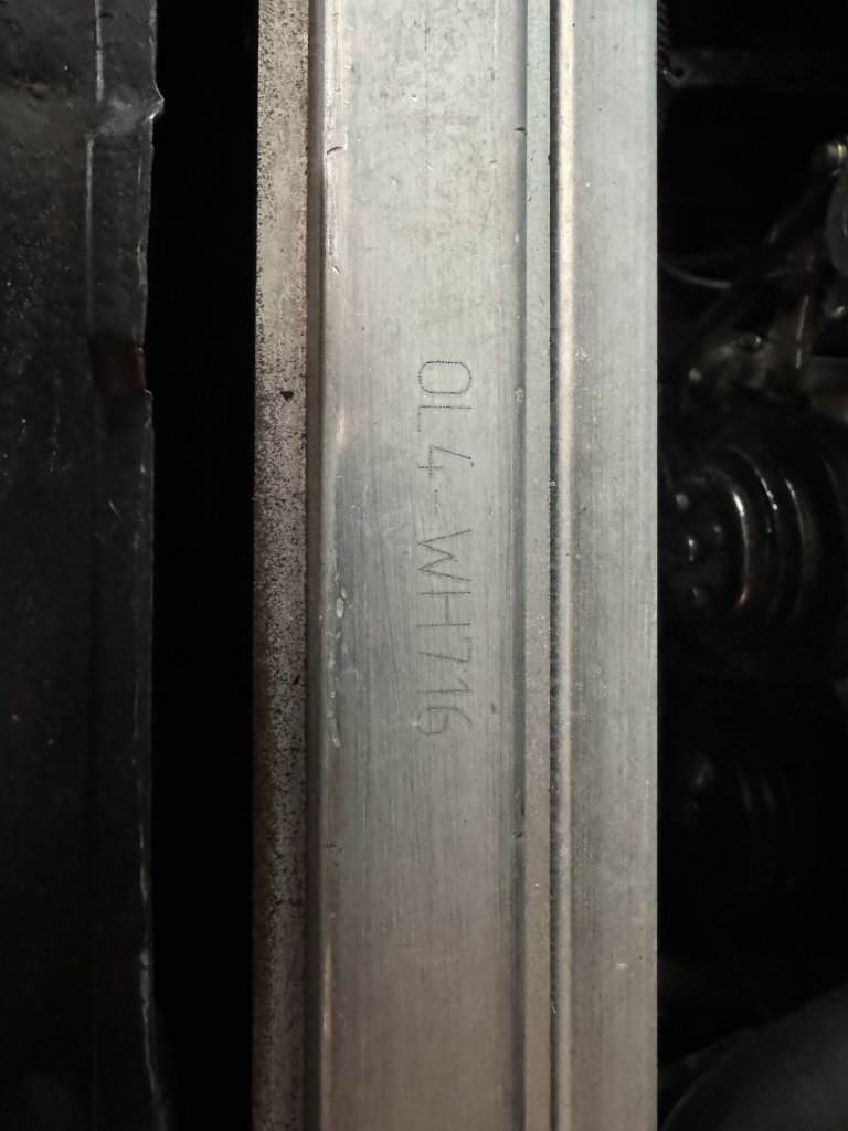

I did this as well on my 85 K10. Cold Case is a solid radiator. I modified the original brackets and then 3D printed new inserts for the top and bottom. I went with electric fans so I didn’t have to worry about the shroud, but that would have been a chore
Here is the measurement you need. There is a tall one and a shorter one available. If yours uses the same brackets as mine, it’s the tall one. The short ones (I think they are 1.5” shorter) were for 6cylinders I think. The other deciding factor is if it has factory air or not. My truck came stock with a 305 and AC.
