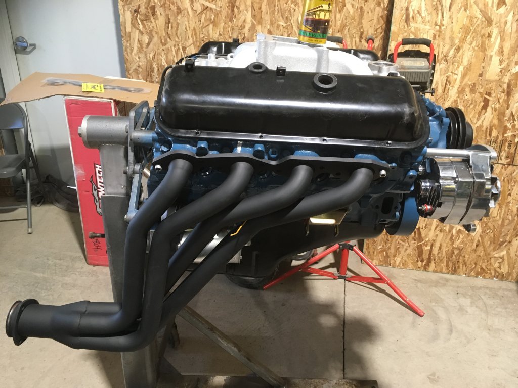

Nice setup to begin with the 4L 80 E has a .76 I believe overdrive calculate your tire size rear end gear in overdrive for over the highway RPM and set up your motor to work in that range. I have a small RV cam ebrock air gap intake manifold 750 Holly flow tech 1 7/8 headers. You don’t need to power brake to burn off the tires.
