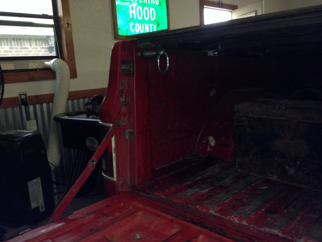

Got the flatbar welded in, here's a couple pics . All that's left is a little grinding if the welds and paint. I also put some spring latches on it to lock the bed cover, I have an idea for a tailgate lock but not sure if it'll work.

And the latch.

Here's a little better pic of the other latch

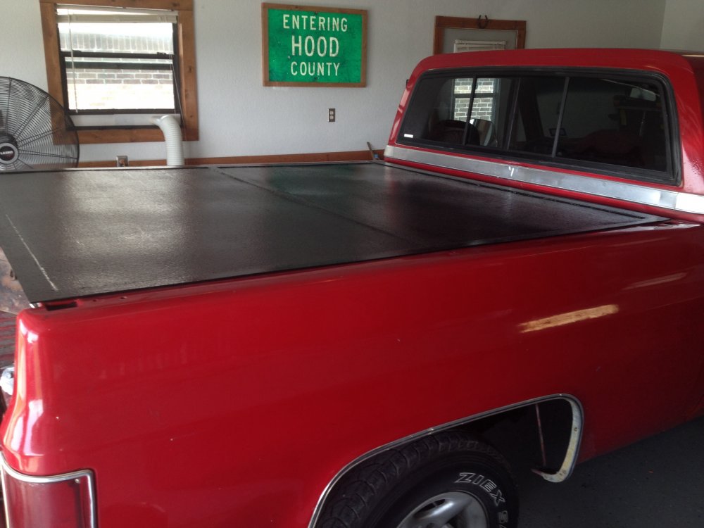

Got it lined with bed liner, so I guess it's finished. As far as the bed liner looks, meh.

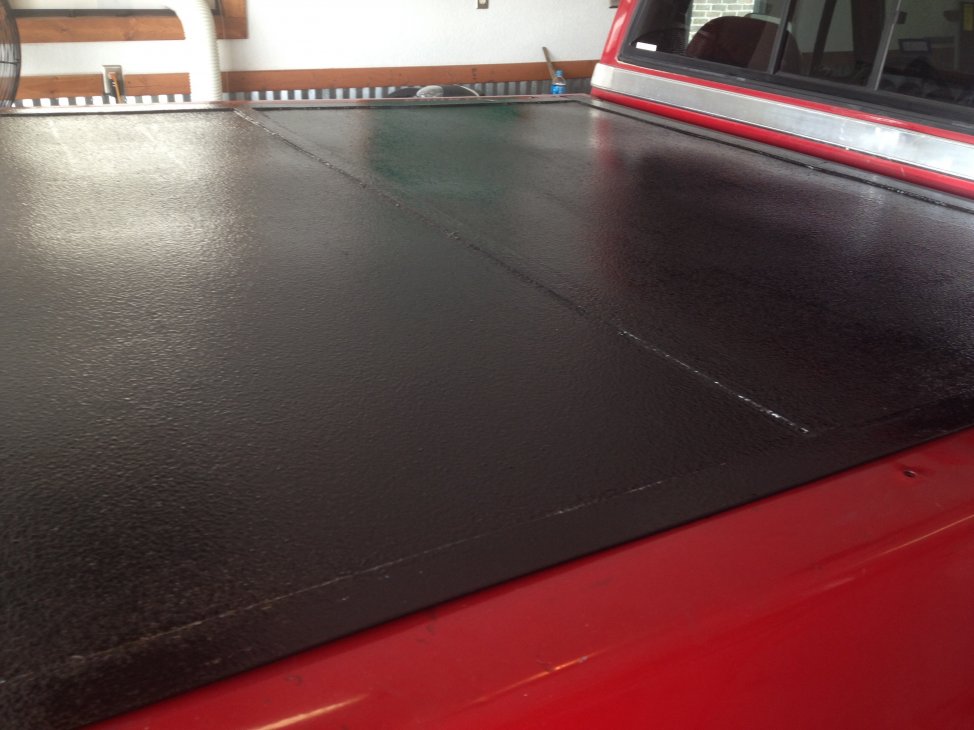

A little closer up

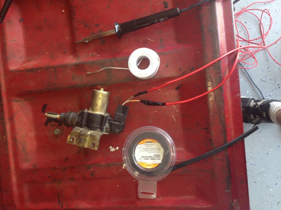

First find an actuator. Taking the one from the parts burb made it easy as the wires were the same colors when looking under the dash. I added about 15 ft of wire to each side of the plug to run down the bed and into the cab.

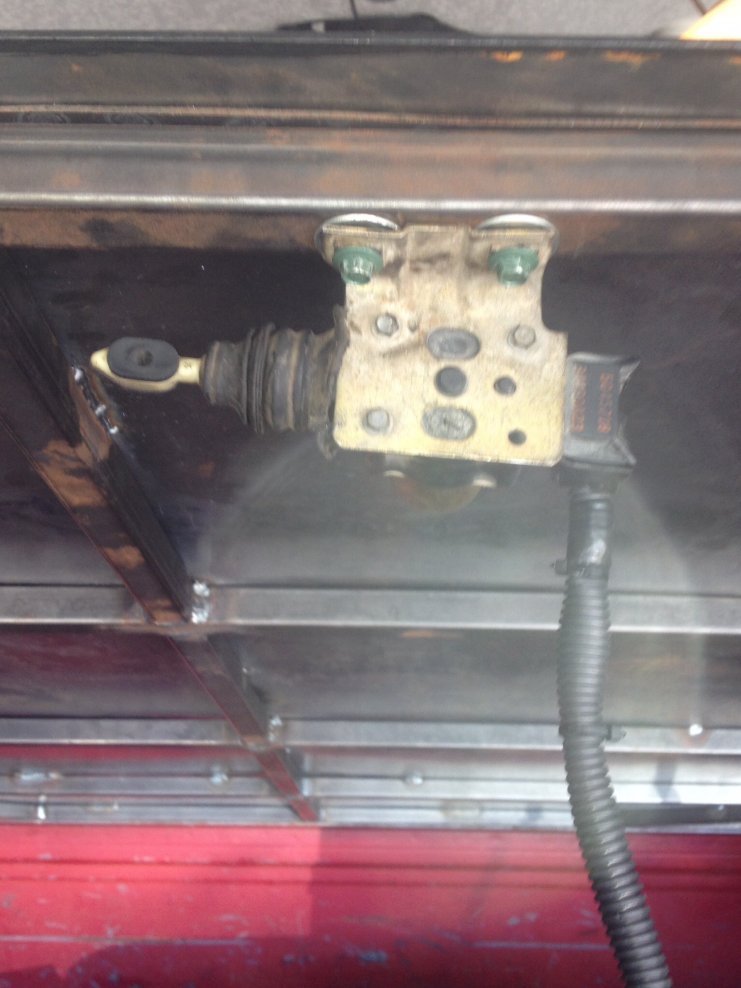

Next I screwed the actuator to the rear of the bedcover with self drillers and ran the wire down the center of the bedcover.
