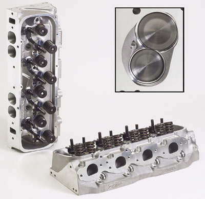

After my latest valve seal debacle, I want to put some aluminum heads on my suburban. Which will be best for towing and low to mid range torque (plus street fun)? I’m punched out to 461ci with an rpm air gap and sniper II.

And the heads I’m considering:
31,892
32,686
If I can ever swing a set of big block aluminum heads to try out on one of my trucks, the Trick Flow power oval 280's are at the top of my list.

Hard choice on heads. I do know Brodix have great customer service and i never seen a cracked Brodix head.
I have seen a cracked LS TFS head but not for a big block. Good thread here

Hard to go wrong with either one. For your setup I like the smaller intake runner of the Brodix but for compression I like the 113cc of the Trick Flow head. I would be looking for at least 9.0-1 and 9.5-1 would be better.
It will run fine with either head. Go with the most affordable of the two(my wallet talking).

I ended up going with the afr 265cc 109cc chamber. Should get my compression to 9.5:1

I absolutely would NOT go to the expense of putting aluminum heads on a sub 5k rpm motor, what’s the point? I would put that $3k elsewhere.
Since you’re obviously not going to spin it any real amount (1400-4600rpm cam) I’d put $1k or so into so OE iron heads. I’d get some early oval port heads, leave the small valves in them and roll with it. The $2k saved could pay for an intake, headers and exhaust.

Thanks! The rpm intake that we have on the engine (and fuel injection) will merry up much better than these small peanut ports. How much, we will see this week. We also are running long tubes and 2.5” stainless x piped exhaust all the way back.

Better heat dissipation (allowing higher compression) and lighter weight (less weight: more acceleration) both come to mind.
Besides that, many of these aluminum heads have great flow at low lift levels which equates to more power at normal RPMs, compared to a decent stock head.

I am building a 489 right now, here is a link: https://www.gmsquarebody.com/threads/bbc-489-build.45389/. Depends what you want, top end HP or tons of torque and good power. Trick flow280's, Brodix 290, AFR 265 are all excellent. The smaller the CI, the smaller the head to get good velocity in the ports. 10 cc pistons with a -.015 in the hole piston will probably be around 9.5:1, so ok. If you need roller rockers, I would use at least a 1.8, as the engine would like the lift, valves will clear easily, helps with off the seat flow. Maybe think about advancing a few degrees with an adj timing chain set. Buy some cheap tires, your gonna need them.

Thanks!
With the sniper 2 system and hyper-spark distributitor, I’m running timing at 36 degrees.
My soon to be setup is as follows:
461 .030 block
sniper 2
Hyperspark ignition
Air gap intake
Afr 265 heads
Howard’s roller cam, dur at .50: 213 int./221 exh.
10cc small dome pistons
Crane gold 1.7 roller rockers
1.75” od to 3” headers
2.5” hooker black heart stainless x pipe exhaust
