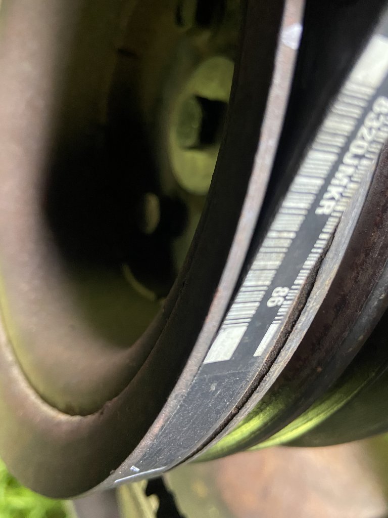

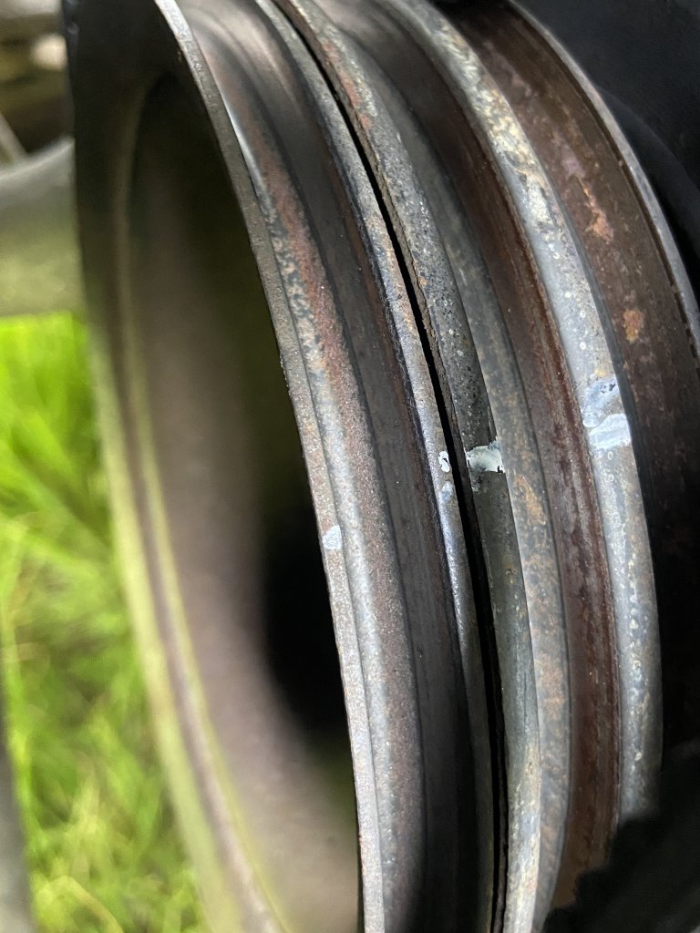

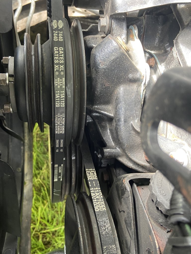

Take a look at these pic, anyone think the belt is riding to low in the groove?
This is the belt as it sits on the crank pulley.
The pulley without belt ( although rides in groove furthest from block
Belt as it rides over the fan pulley

AuroraGirl
Sep 8, 2019
10,710
8,239
Northern Wisconsin
Taylor
1978, 1980
K10, K25
400(?), 350
Belt removed : noise gone
Belt on with any degree of tightness squeals like a pig..
your pulley groove might be getting worn
Okay I can see this being a possibility.
Is this a fire the parts cannon situation? Grab a new pulley and belt and pray?
no, get some more up close pictures of the pulley , maybe put a bit of white paint on the the thing with a paint marker so its contrasted
