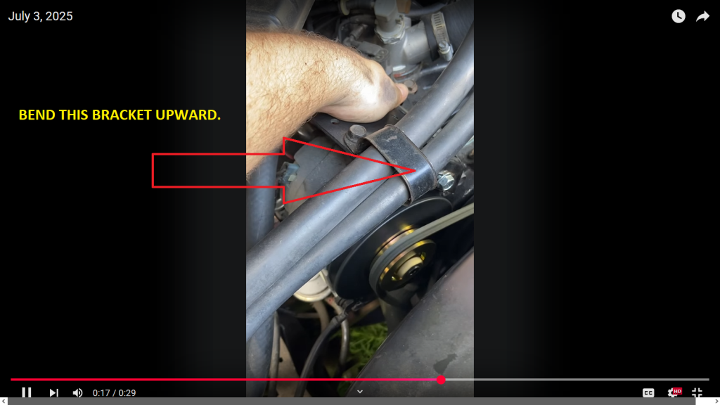

I wonder if the alternator pulley rubbing against that metal hose bracket is what caused the alternator bearings to go bad...
