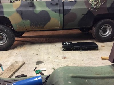

Well guys, back with another possible problem. Got the Dana 60 from the donor 1028 put in today. Jacked it up, locked in hubs and put transfer case in gear, marked the tires and rotated the driveshaft 12 complete turns. Front tires pointing at 2:00 and rear tires at 5:00!!! I dont get it, front and rear should now be 4.56 gears. Is this an acceptable margin of error or am I gonna screw up my transfer case the first time I engage the front axle?
You can see the position of the white marks in the picture below.

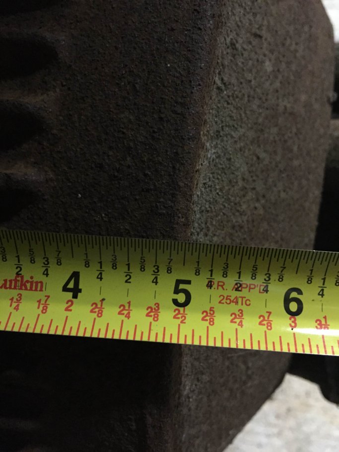

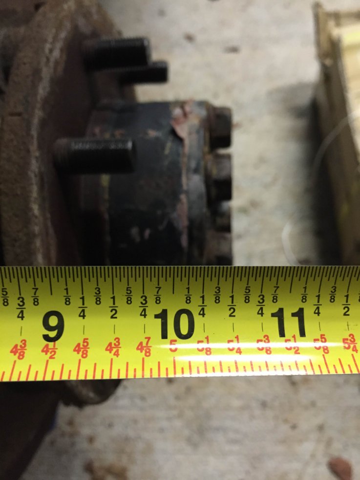

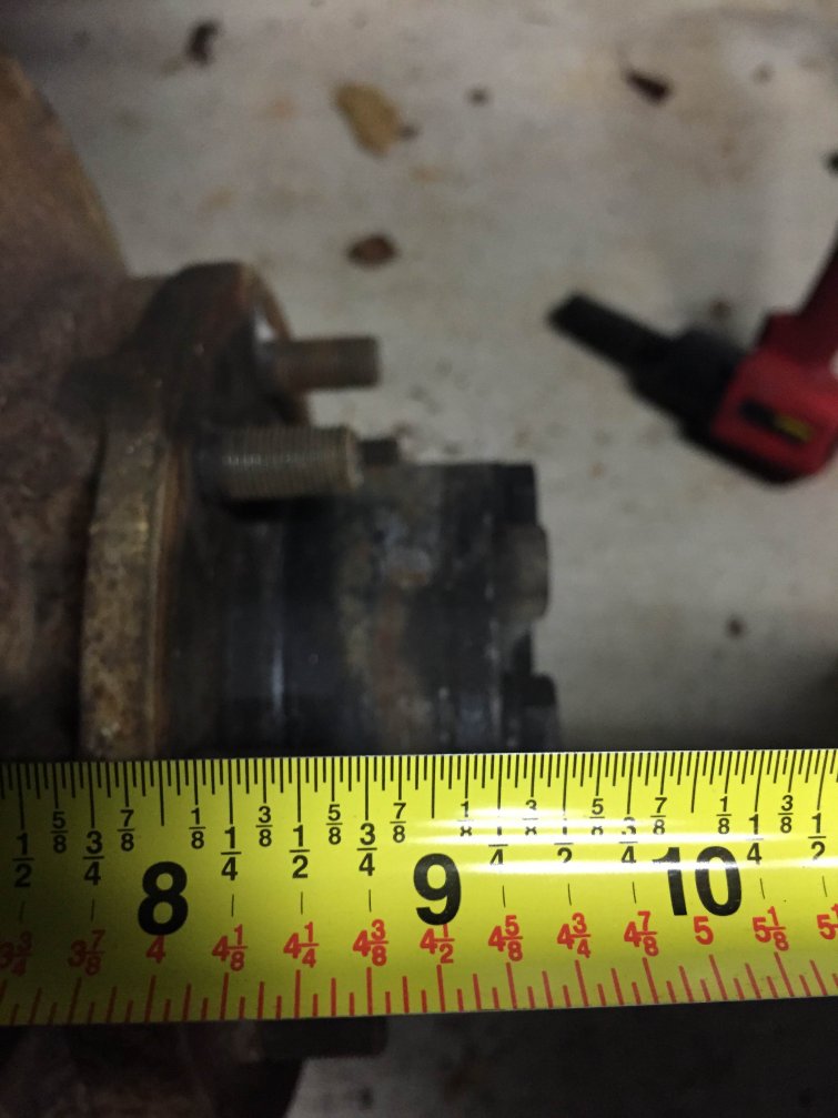

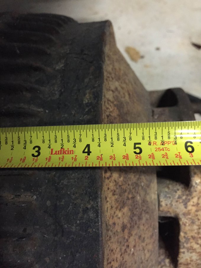

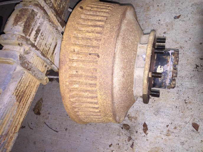

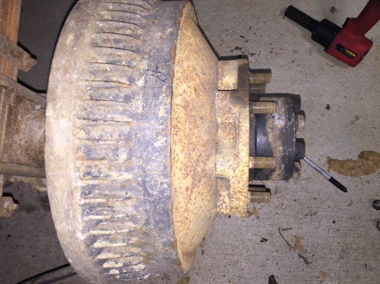

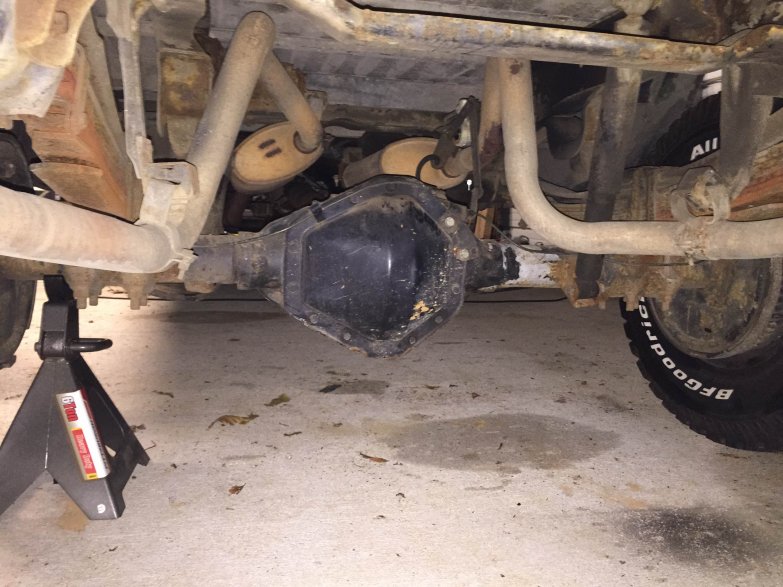

Ok got another question. (big surprise right?)
Do 14 bolt 1 ton axles have different size drums? I noticed the drums on my parts truck are larger than my good truck. Axle tube diameter and shock bracket spacing are the same on both axles so they should both be 1 tons, although the shock mounts are a bit different on the 2 axles.
Also on the parts truck the ebrake line for passenger drum is longer, comes over to driver side before joining up with it. While on the good truck both side ebrake cables are the same length and meet up in the middle.
Could one axle be a semi floater and one a full floater? Wondering if the one with the bigger drums is better, and if I should plan on swapping it over to my good truck?:shrug:
Here are some pics to better explain it.
NedFlanders
Nov 11, 2014
43
Asheville, NC
Ned
k30
6.2
Heres the rest of the pics.
31,901
32,701
Those are both 1-ton axles. There were optional bigger brake drums, and the difference in the e-brake cables is a model year thing. IIRC, the cable setup changed in '84. The later axle might also have stamped spring perches rather than cast.
The difference in shock mounts might be because of the model year too. Is the axle with the lower hanging mounts a 2wd truck?
