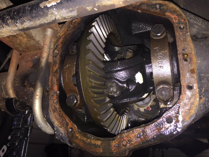

Looks like I have 45 teeth on the ring gear, and 11 on the pinion. So I guess my ratio is 4.09 correct? After reading a couple posts about gear swaps changing this to a 4.56 sounds like something best left to the pros since I have no axle experience. Any idea what a ballpark figure would be for something like this?
for the price you should go out and find a dana 60 from a cucv with 4.56 find a m1028 with a trac loc!
