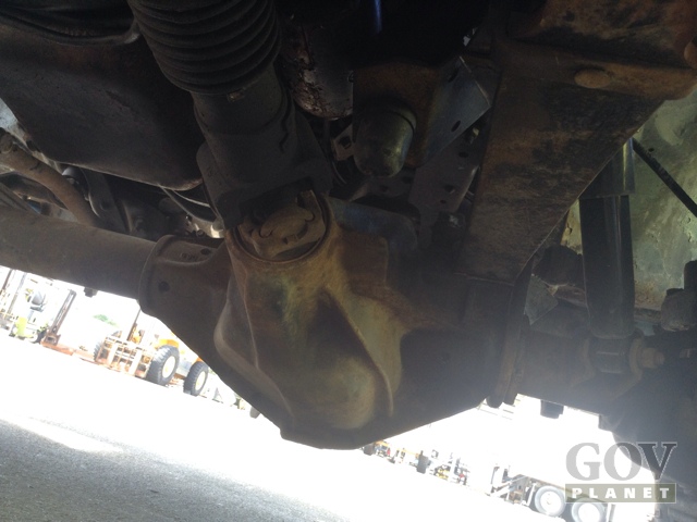

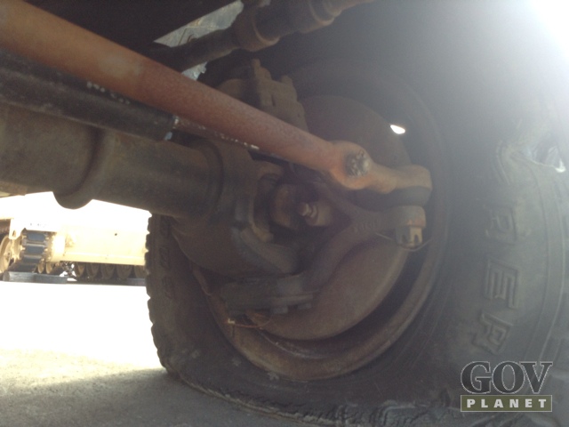

need your help again guys!
Got a lead on a possible m1028 donor truck that supposedly still has the dana 60 front axle. I only have 2 pictures, and neither of them is very good. But one shows kingpins instead of ball joints so thats a good sign!
What do you think, dana 60 or not?
yes that's it. If I was you id pull the cover and look for the trac-lock that should be in there.
it looks just like a open diff but if you look closely you should be a pack of clutches
Thats good since I won the auction for it!
Thanks for the help. :cheers:
