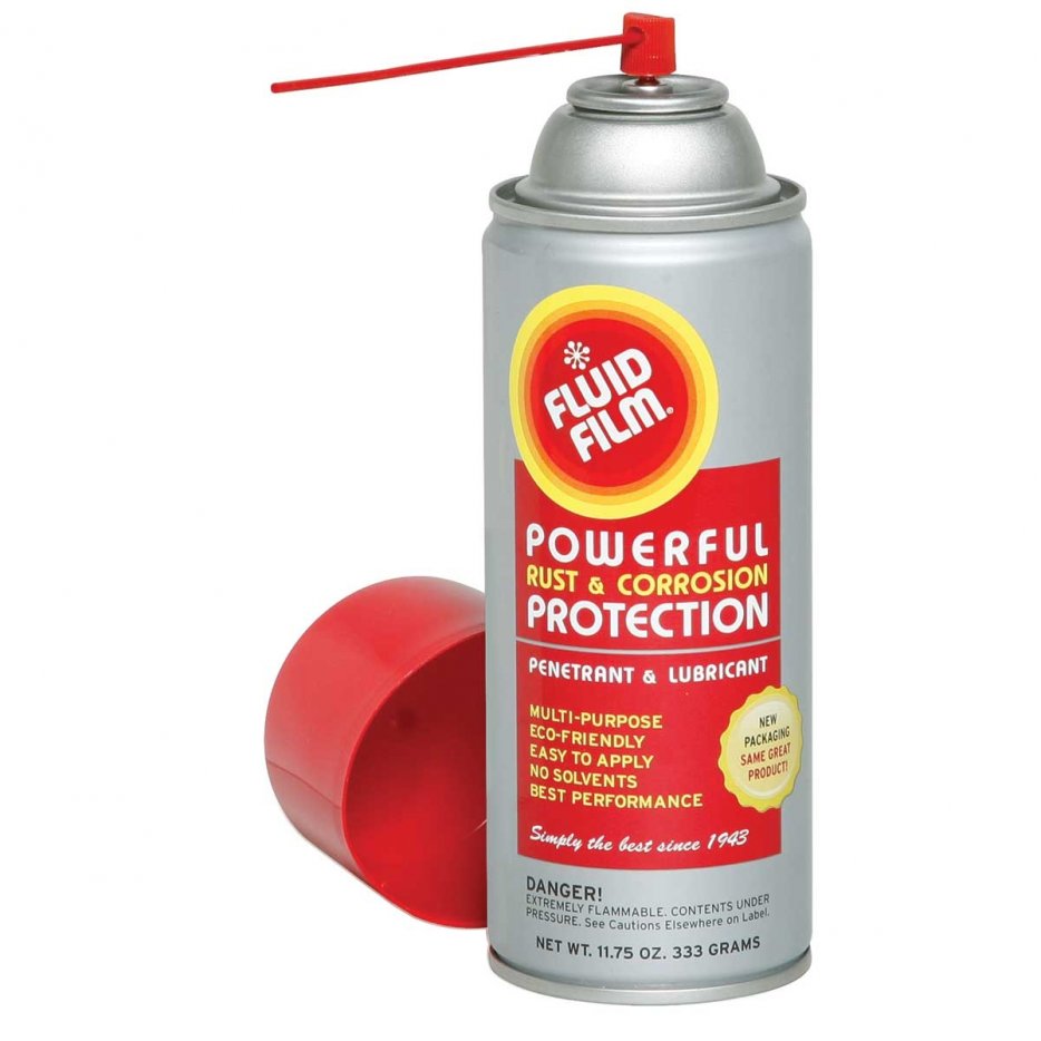

this what your talking about I assume it is. Gemplers eems to have a decent price on it but I may check locally first I have a few agri supply shops. Did you spray it on the actual motor? mine are slow but I was just going to replace them?...

Yep, that is what I bought. I have crank windows- so I just soaked everything in the door. I'm not sure I'd spray a motor with that.
One of the articles I read about the stuff said some state back east uses it now to soak down their trucks for winter protection (road department). They have had a lot less maintenance after using this for protection. I'll see if I can find it later.
