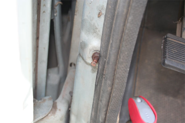

Anyone know how to get to this switch?

Thought maybe there would be access once the kick panel was removed.. Not so! It's solid sheet metal there..
Looked in the jamb.. Crawled underneath the truck to see if there was any access from underneath... Nope..
Is there some trick I'm missing, or are we expected to fish it through the 1" hole up inside the dash where the wire comes out? Or at least i 'think' it's a 1" hole.. There a rubber plug about that size there...

Okay, it just screws out... I was afraid to do that, thinking it was a nut on the switch put in from the back, I feared it would just fall into the cab innards never to be seen again... or once loosened never being able to be tightened again without being able to hold the back while doing so...
It's definitely bad.. Need a new one...

I installed it, and the male connector on the wire that I used to replace the existing corroded one with fell out when I slammed the door shut, so I ended up having to fish the damn wire out that little hole anyways, which was actually quite easy.. put it back in the connector, and lightly crimped it..
Now the courtesy light and new LED dome light work as they should..
But I put the courtesy lamp on the passenger side of the hump, now I need one for the driver's side, but I can only find them sold as complete sets, with 2 of the lamp holders, two jamb switches, and a wire harness... priced anywhere from $25 to $100 plus shipping..
I just want the damn socket.. just one.. Might have to redneck something up..
