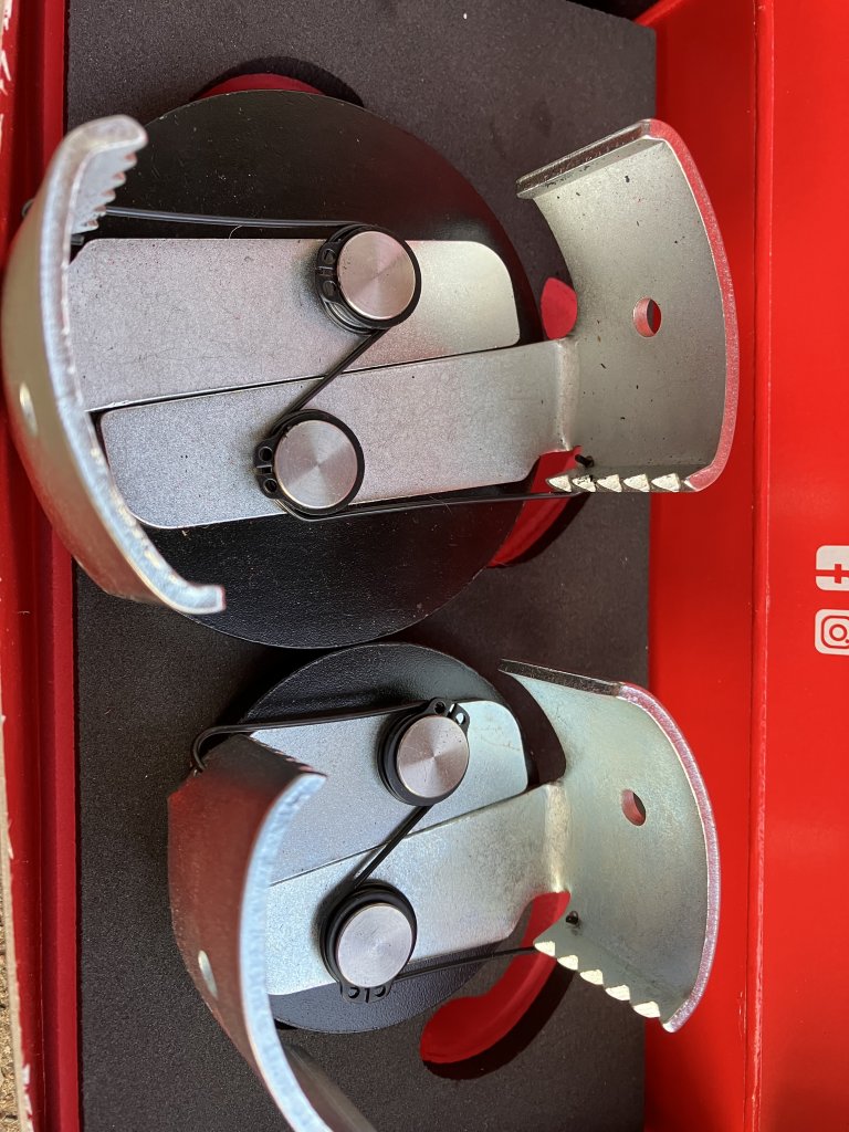

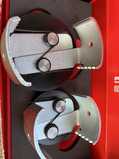

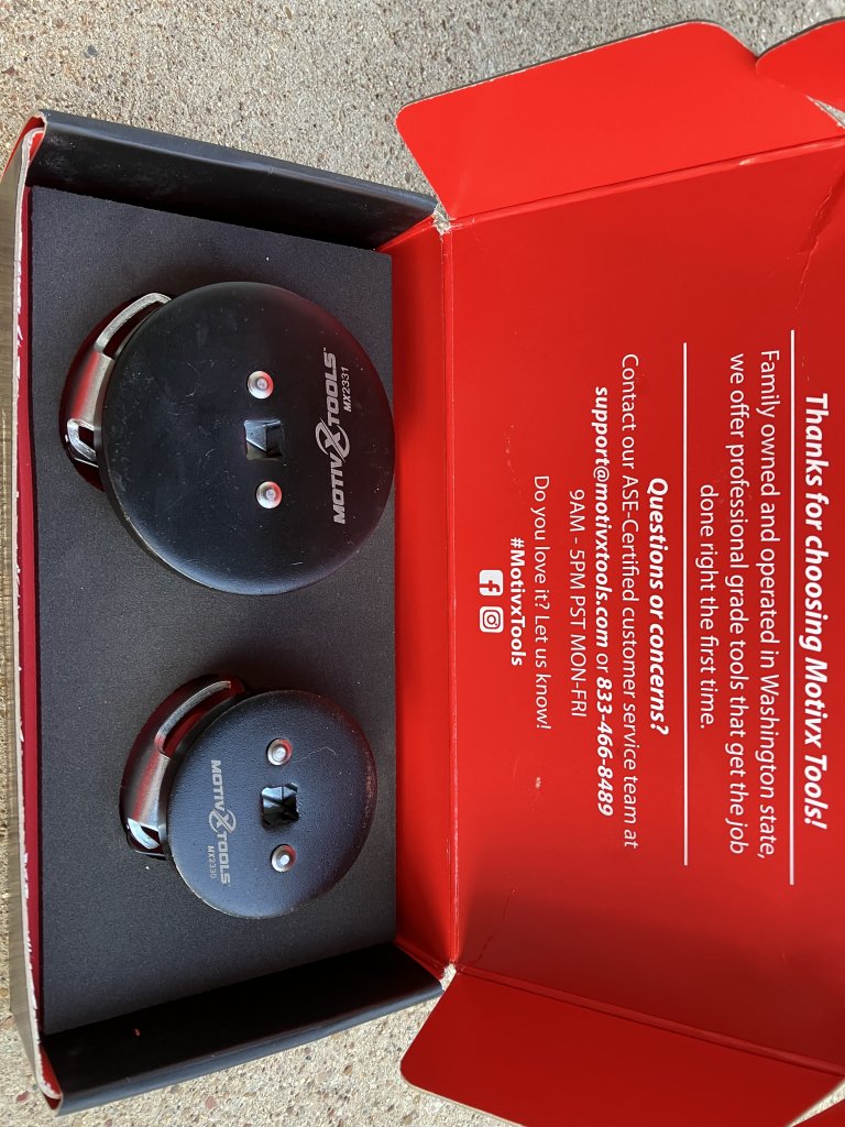

Oh man, I’m sorry I didn’t see this conversation earlier. I once had an oil filter that would not come off with any tool that I had, to use on my ‘68 Olds Cutlass/Olds 350 and there wasn’t enough clearance to use a screwdriver long enough to get enough leverage on. I found this tool and it is absolutely the best. It got the filter off even after I mangled it using the other methods. This set comes in two different sizes (MX2330, MX2331). The harder you twist it, the teeth dig deeper and deeper. I know, it’s not very often you run across a tight fitting filter but you should have this in your arsenal for just those occasions, and it’s made in America. www.motivxtools.com
