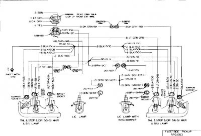

First thing to do is check your ground for the rear lamps, dim lights indicate a bad ground. If you have a fleetside then it will be behind the driver side tail lamp. Next, check the sockets for each rear bulb. Make sure they are not corroded and all contacts are clean. Then check your flasher. It is the bottom right one in your fuse panel. Switch it out with the hazard one and see if that corrects it.
If none of that works then write back to us, we will get in more depth about checking the NSS and the rest of the wiring.
PS here is the diagram for the rear tail lamps.

ok, got back out in the garage. I cleaned up all the grounds and added a grounding strap to the bed. It appears that everything works right now. Thanks again
