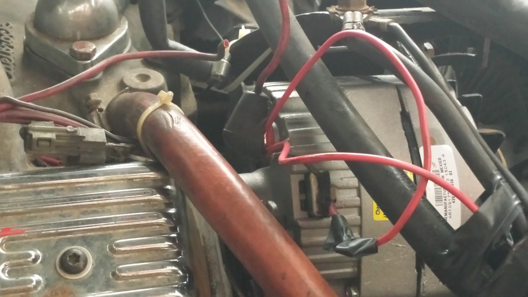

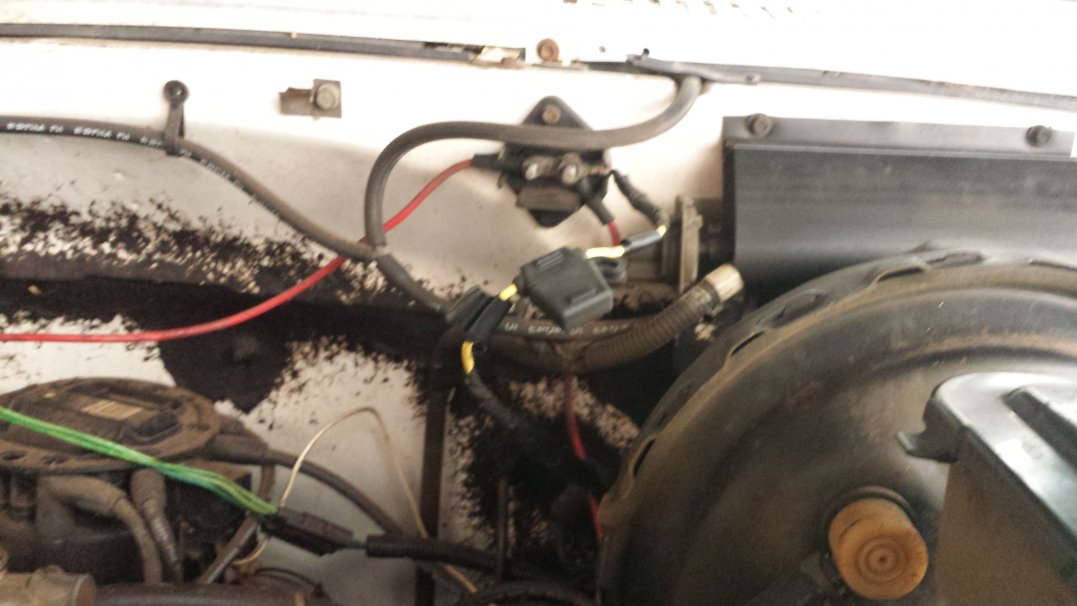

I bought an 86 K10 a couple of weeks ago and have an issue with the electrical system. A couple of hours into driving it home, I had to turn on the headlights, which began to go dim after about 30 minutes. I've got a new battery and a new alternator less than a month old, but the wiring seems to be screwed up (picture below). There are three wires coming out of the back of the alternator. One to the positive terminal of the battery, one to ground, and one that loops from the side of the alternator to the rear of the alternator. The rest of the original wires have been cut. The guy that sold me the truck said the voltage regulator is internal to the alternator, but I suck at electrical stuff and don't know that for sure.

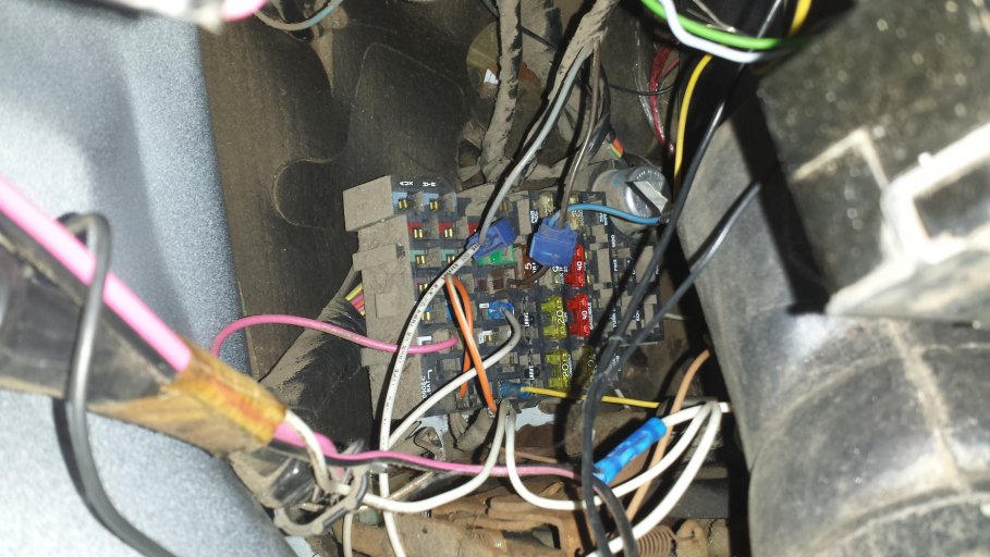

Also, the truck blew a 30 amp fuse near the firewall (pictured below) when we reached highway speed. I swapped the fuse to a 40 amp because we were on the side of the interstate and got it home. The fuse has been added, and when it blew, the truck immediately quit running at 60 mph. The ignition switch was dead, but it immediately fired back up after I replaced it.

Here are the pictures.

The PO burned up the fusible link and replaced it with an inline fuse holder. He probably blew a more few fuses. He guessed that the short was in the big red lead that normally runs from the link to the stud connection on the alternator. So he cut that lead at both ends. Here is the cut at the alternator end:
and supplied the power straight over from the battery positive. Nothing really wrong - just looks like crap.
Problem was/is - the short wasn't in that lead. This is evidenced by the fact that you are still blowing that inline fuse.
So now you have that hack job and you still have an unresolved short to ground in the primary lead that runs from the fusible link (now a fuse holder) into the cab. Once through the firewall, it splits and supplies power to the ignition switch and also the part of the fuse block that feeds the wipers, radio and brake lights.
You have to locate the short to ground in that circuit.

Thanks again for the in-depth response. I called the 1-800 number on the new alternator and the support rep had me reconnect the brown wire on the alternator pigtail (it was cut). Now things seem to be back to normal. 14.2 volts at the battery with the motor running per the tester at AutoZone. I cycled the headlights and the alternator responded normally.

1. Does the fuse in the in-line holder ever blow when the key is off?
The fuse doesn't blow with the key off, but blew once at highway speeds with a 30A fuse installed. I got it up to highway speeds again this weekend after replacing the carburetor with no issue. There's a 40A in there now. When it blew, the motor quit and the ignition switch didn't work.
The size of the fuse doesn't matter. You have a intermittent dead short to ground. That condition would blow a 100 amp fuse - if they made them.
Also, I can't imagine any scenario where road speed would have any effect on the amp draw in that lead. You can probably assume that the fuse blowing when you reached highway speed was just a coincidence. It could just as well happen backing out of your driveway.
What is important is that the fuse hasn't blown with the key in the OFF position. That tells you that the problem exists "downstream" of the ignition switch - rather than between the in-line fuse and the ignition switch.
Unfortunately, that makes locating the short way more difficult.
If the fuse had blown with the key OFF, it would have kind of narrowed things down to one wire. But since it is happening after the ignition switch, it opens a good number of branch circuits as possible shorts.
Here's what I would do:
Get a big handful of fuses (20 amps is plenty)
Put a good one in the fuse holder
Get under the dash and start shaking wires.
With any luck, the fuse will blow.
To tell when the fuse blows:
1. You can have an assistant watch the fuse (not the best option)
2. Wire a test lamp into the big red lead and bring it in the cab with you (if the light goes out when you shake in a certain area you know you are close)
3. Fix your radio and turn it on (the radio will quit when you shake the sensitive spot)
It may take a few fuse changes, but eventually you should start to get a feel for where the short to ground is occurring.
When/if you find it, come back here and someone will help you straighten out the rest of the wiring mess.

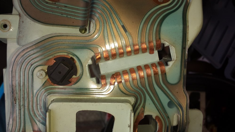

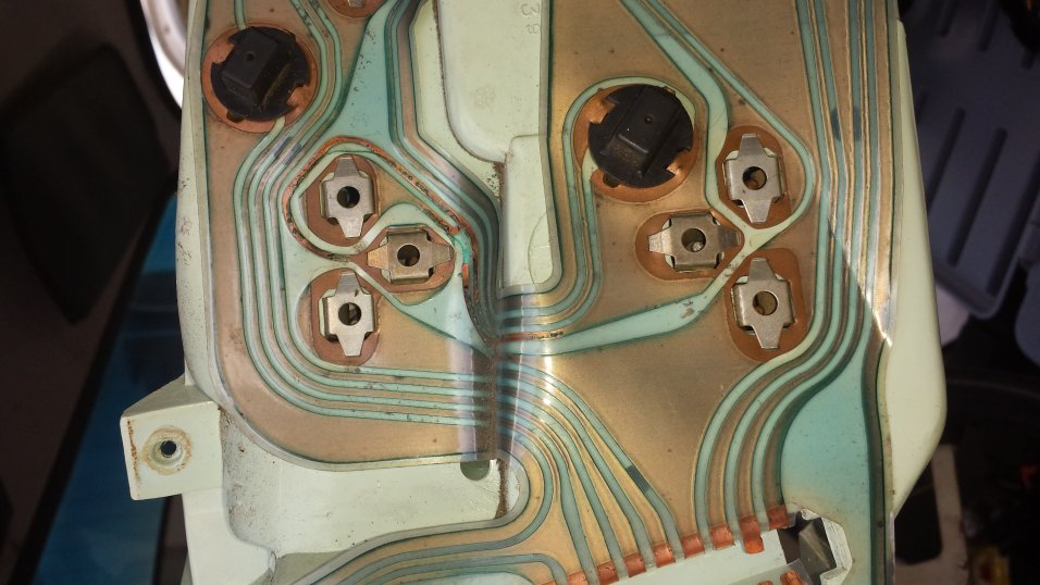

I just got the truck back from having some steering components replaced and have started to poke around with the electrics a bit. I removed the gauge cluster, which was unplugged when I bought it, and found a burnt wire and a short in the flexible circuit board. The burnt wire was for the oil pressure gauge and the short was at the main connector where it hooks to the wiring clip. The fuse was also blown at the fuse box. I replaced the fuse and got 12 volts to the clip that plugs into the circuit board. Small victory....

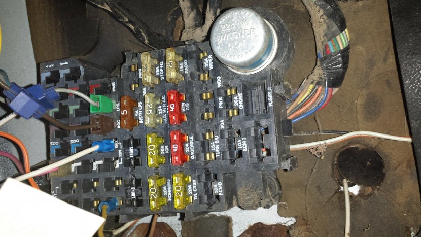

I stuck fuses in the AC and radio slots, but neither one of those work. Do you have a wiring diagram that shows which wire should be hot to each with the key on?
Regarding the big fuse under the hood..... it (thankfully) hasn't blown since the 40A fuse was put in. When it blew, the motor quit. Any chance the items that don't work are related?

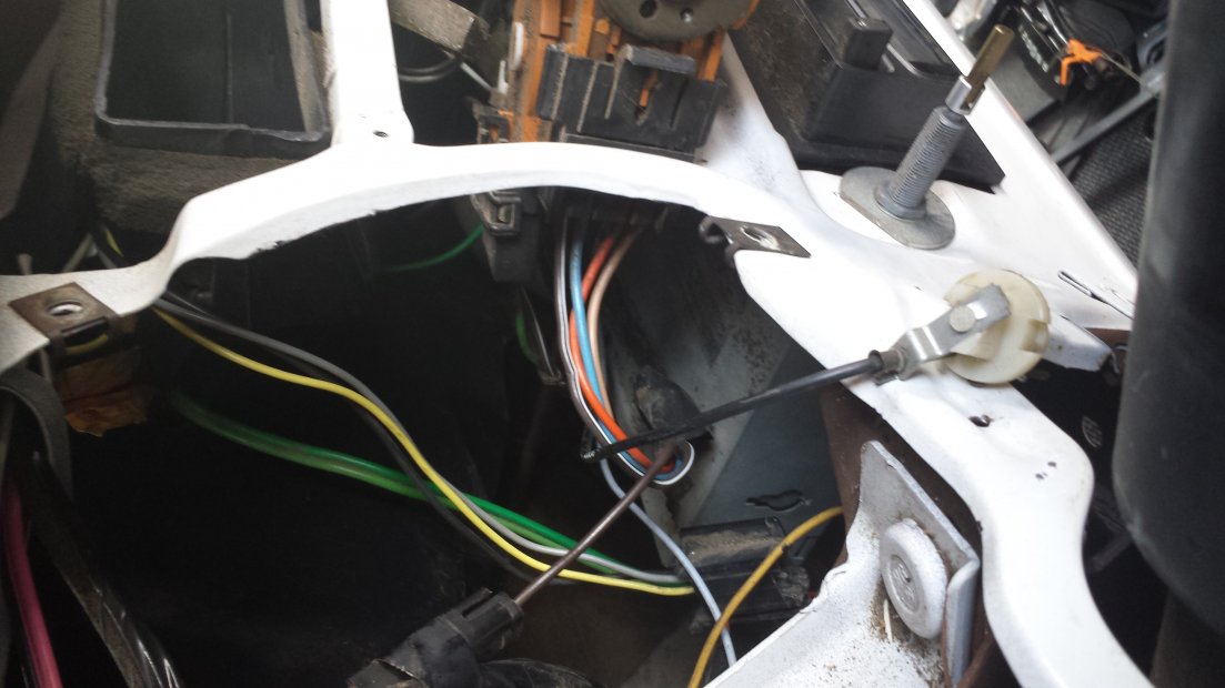

Here are the pictures. The radio looks like it's been added in via the two blue clips and the yellow wire that on the left side of the fuse panel.
