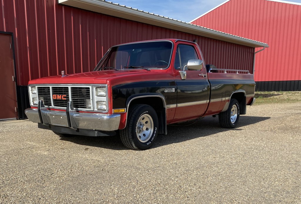

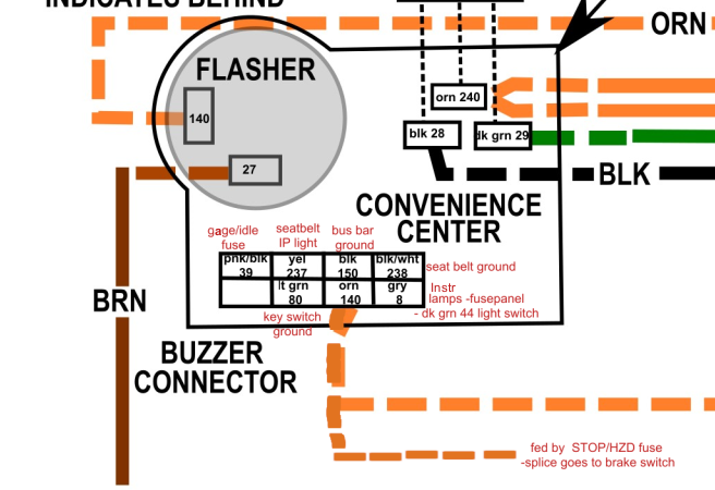

Small issue has me confused. Driving down the road and everything is fine and normal... Turn headlights on and the choke dash light comes on, headlight on warning alarm(like when you forget to turn headlights off after shutting truck off) sounds comes on. No other issues that i notice. Drove the truck from May 25- Sept 30 and everything was fine. Parked for 4 weeks and took it out for a final run before winter storage and the issue showed up. Could this be a grounding issues? Where are all the grounds be located? Truck is pretty much all stock, factory radio, nothing aftermarket added, but did put a new crate engine in it in May of 2023.
