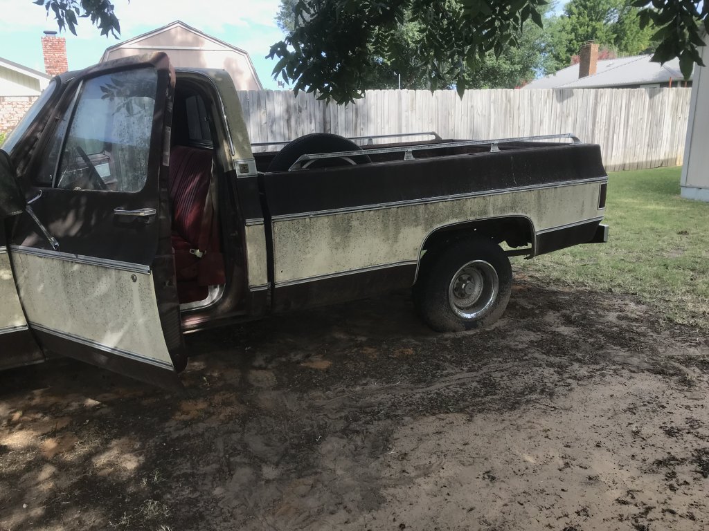

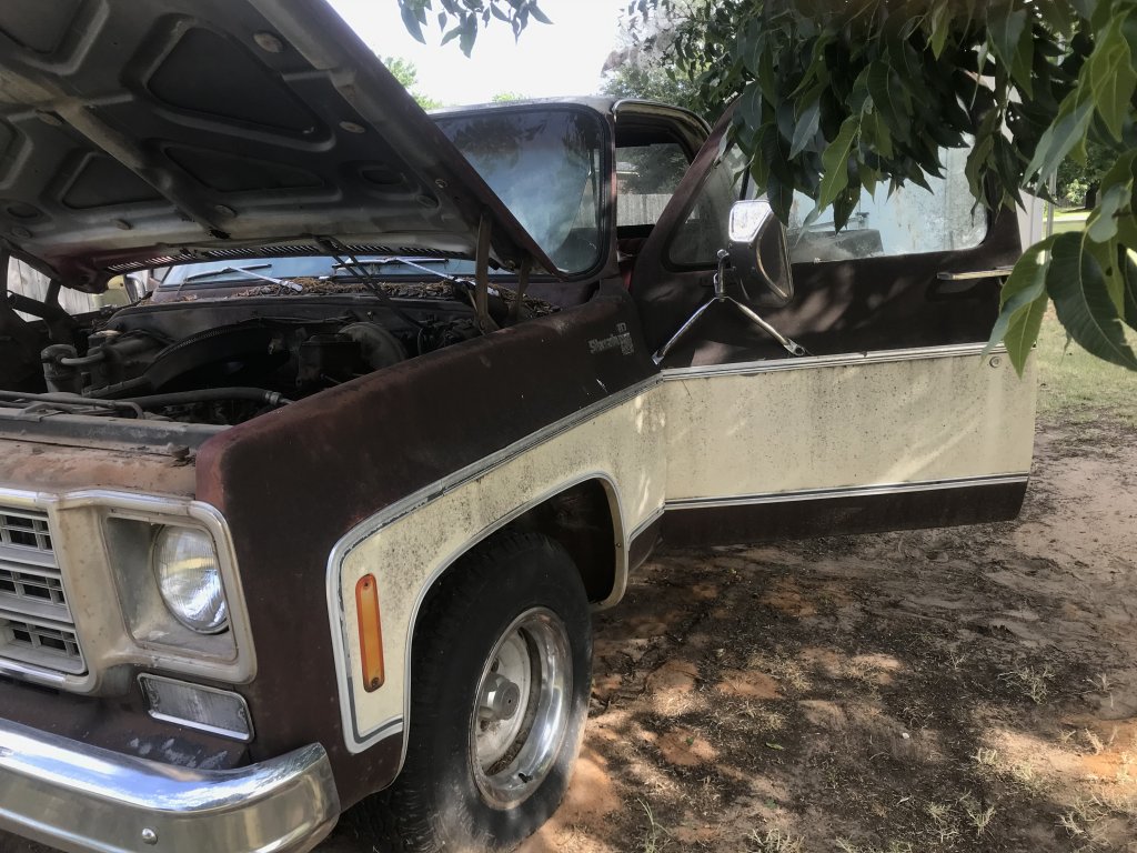

Fairly new to the forum, joined just before my purchase....so I could get back to re-learning.
Purchased this one owner from the distant in-laws last summer. She's all original, within reason.
Was setting about 7 or so years. Had one similar to this 23 years ago, but another sad story.....
I've been through the fuel system, brakes (new rubber lines and flushed), Quadrajet, new tires. Fired right off.
Added 4 pints of Dexron III and changed the oil. She's a runner!
Now she just needs "some Love".
