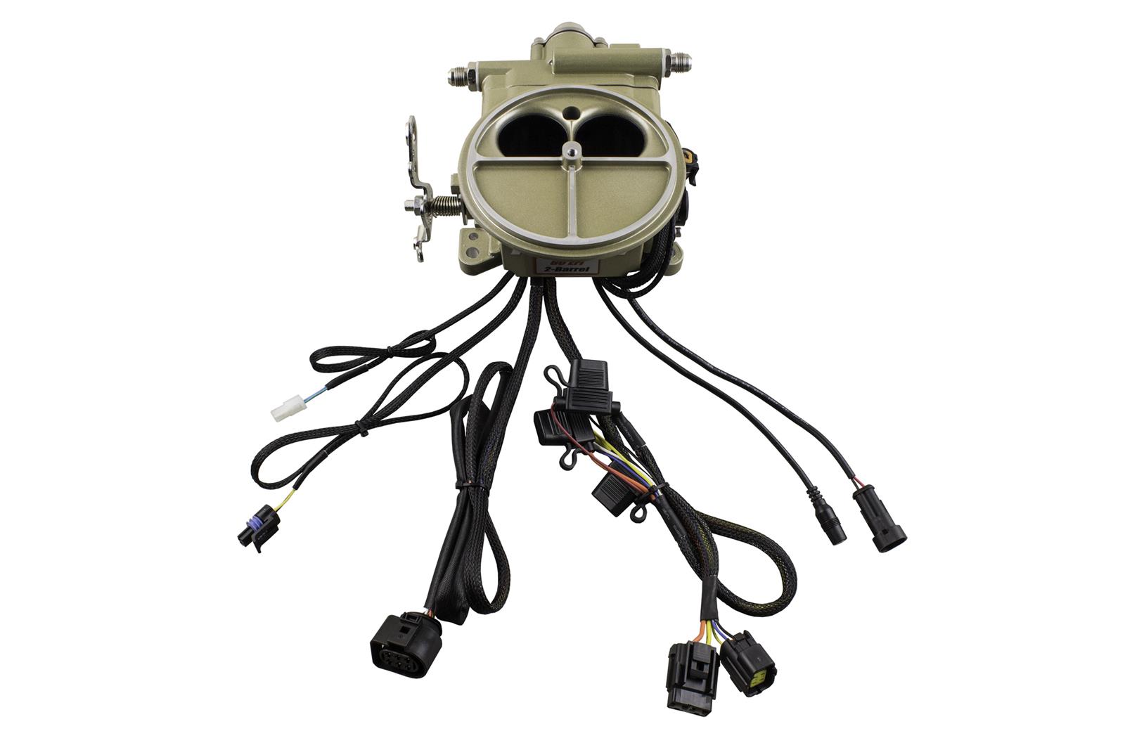

Thanks for the reply’s. I’m getting the truck this weekend. I know it has a stock component rebuilt 350 with a mild cam. My Father passed and I’m inheriting the truck. I know it has an edelbrock on it. I think he had a free 750 on it and swapped it out for a 600. If it is a 600, I try to follow the articles on tuning it.
Hers an example of 2bbl aftermarket fuel injection.

Stay as far away from anything made by fitech as you possibly can. Just when you think your far enough away, take 7 more steps back.
Holley has some smaller systems as well if you don't want the standard 4150 style.
