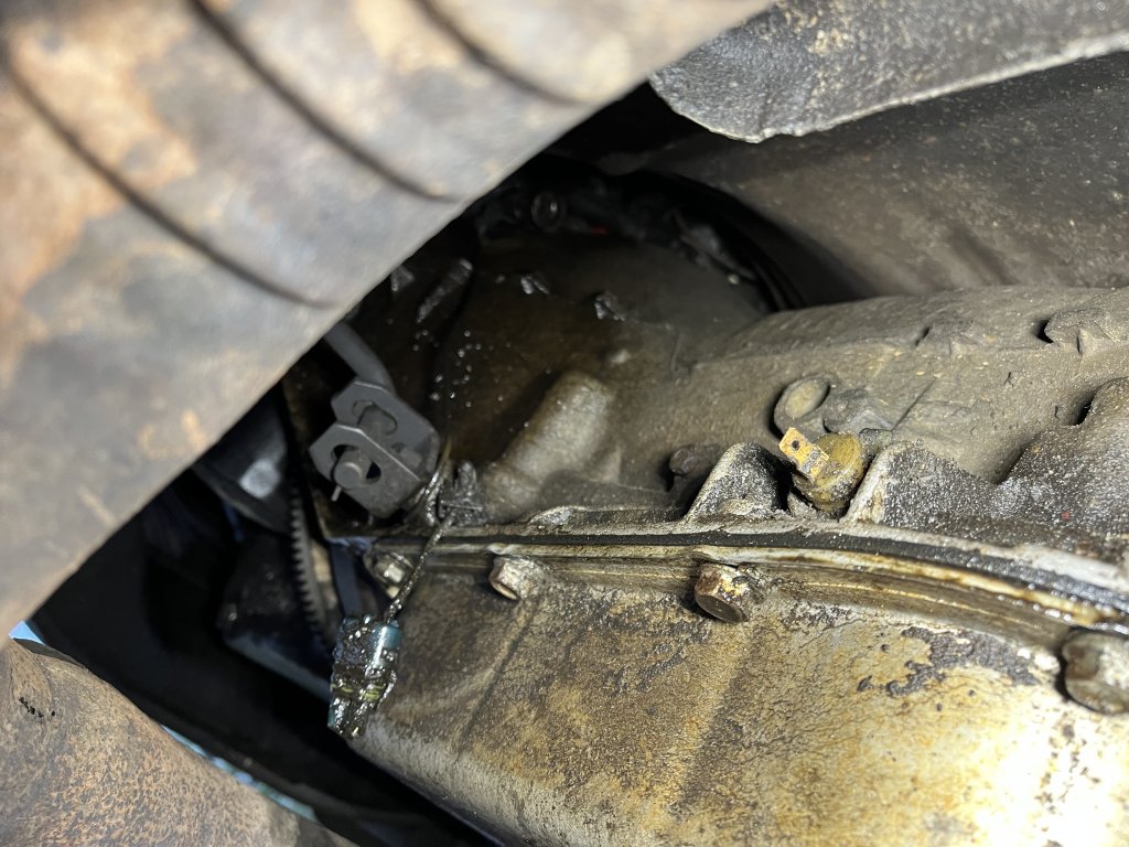

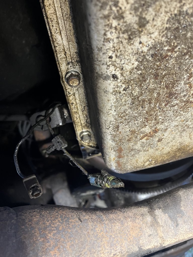

My 81 c20 has been popping out the exhaust like a popgun anything over 45 when I let off the throttle but recently I’ve noticed it around 35-40. The truck does have a leak at the manifold to down pipe, the truck runs and drives decent enough to daily me to work. I’ve noticed theses connectors down by the transmission I’m not sure what they are or if they have anything to do with it any help or advice is appreciated! Thank you in advance
MarineOne
Jan 12, 2023
440
Western New York
I'm guessing your reverse lights don't work Based on connectors ?

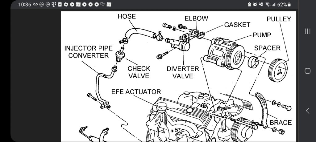

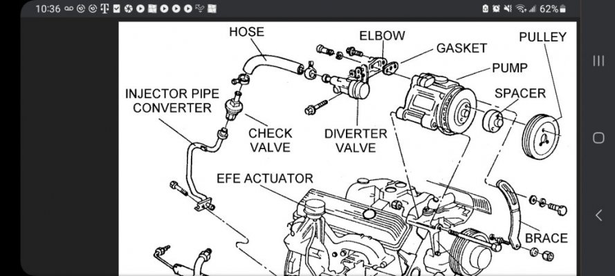

I know each vehicle at this point is basically molested far beyond what it was like when it rolled off the dealership lot. Mine has all the factory equipment, including the smog pump. Is that pump, by design, supposed to pump air into the exhaust? If so, even if my exhaust was leak-free, wouldn't it still have air in the exhaust, thus causing backfires if the decel valve wasn't working properly?
6,476
11,038
The diverted valve prevents air from being pumped in on decel for exactly that reason.
12,012
19,108
Where is the diverter valve?
6,476
11,038
It should be in this order,pump,diverter valve,hose,check valve,injection pipes.
6,476
11,038
Found a pic.
