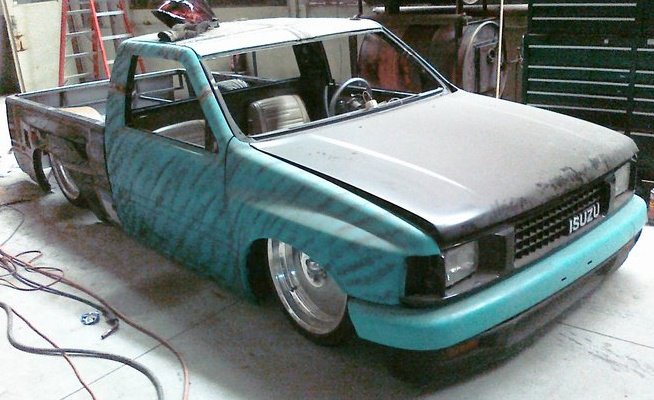

Heres a pic of the 'Zu....It's a pretty badass little truck...SBC..slight chopped top...etc....I'll dig up some photos of the motor/buildup.....He's got all sorts of toys...lol

I'm usually not a fan of anything Isuzu but that little thing is pretty cool!!

Isuzu makes the Duramax, that is in chevy trucks after like 2000 or some ****..... Now an Isuzu truck is getting a chevy engine. Awesome.
