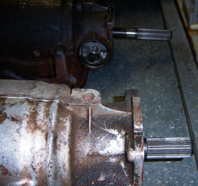

What does this adapter do? It equals the length of the T350 to the 700r4.
Here is a pic of the ends of the cases. Pics don't show it, but the bell housings are matched up side by side. Notice the black Th350 case is shorter than the silver 700r4 case.

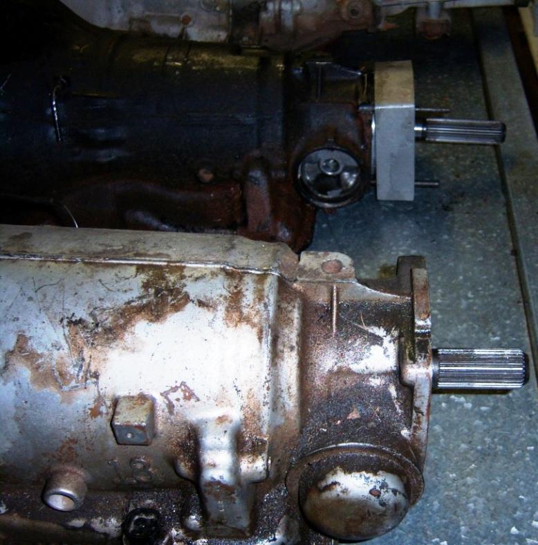

Now the adapter is in place. Its not up tight since the bolts are not tightened, but you see the difference and what's going to happen here.

Are you wondering about that output shaft yet on the Th350??? Notice its to long compared to the 700r4? This is because that is a 2wd Short output shaft for a passenger car. Remember the output shafts on 4x4 transmissions are shorter stubs, just long enough to marry the splines of the Transfer case. With the adapter, an OEM 4x4 Th350 output shaft would be to short. So what's going to happen next, when I get to it, is this 2wd passenger car output shaft will be cut off approximately 1 1/2 inches, so that it will match the overal length of the 700r4 4x4 output shaft. Even with the cut-off, there will be the same or more spline length into the tranfer case and all will be well.
With this adapter, the Th350 will use the same Tcase, Tcase mount, Tcase linkage, crossmember, OEM crossmember position, and also the same driveshafts and yokes both front and rear. Now I'll be able to install either this Th350 or a 700r4 without any other modifications. Man, I love having options without grief. All for Fi Dolla !!! :High 5: It does pay to pay attention and check things out. Sure glad I tripped over that part because I sure wouldn't have spent that kind of money to buy one.

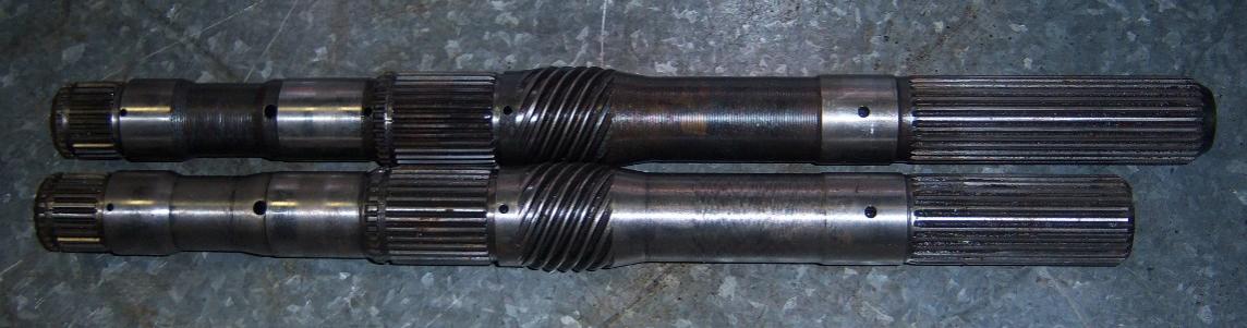

I went ahead and went back to PAP today. I gutted that Th350 to get the shaft out of it too. Knowing they wouldn't sell to me if it was a trans part, the girl asked what it was, I said a driveshaft yoke and she sold it to me for $8. :roflbow:
But as I had said before, I intended on cutting down a short output shaft. Obviously it'll work, so while I have the shaft to the kit out now too, I'll go ahead and match them up, and cut the 2wd short shaft to match so I have a spare incase for a really wierd event, break the output shaft. Of all the years, I've never seen a Th350 break an output shaft, but you never know. Better safe then sorry.

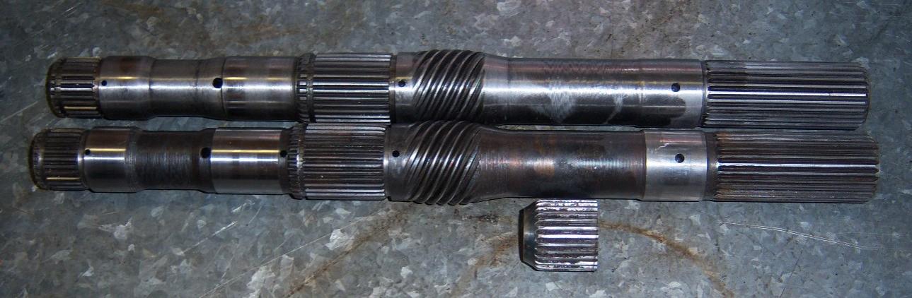

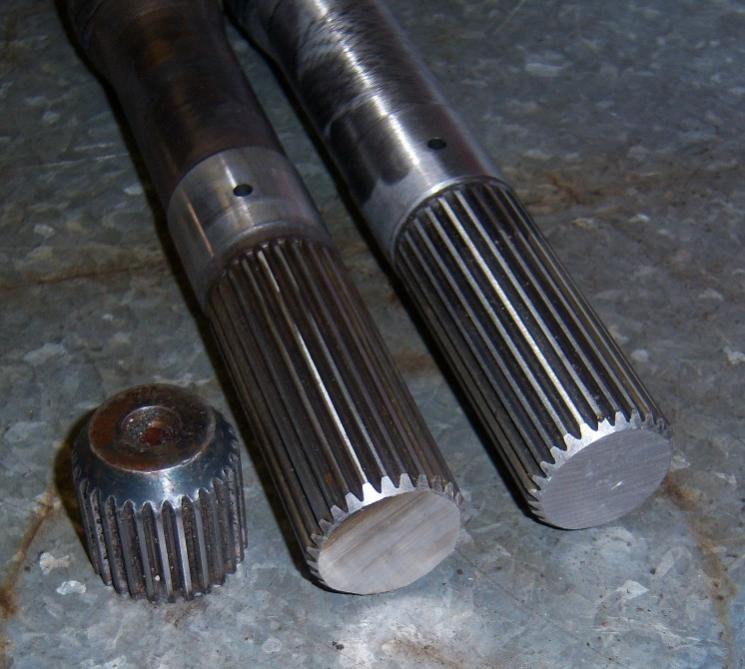

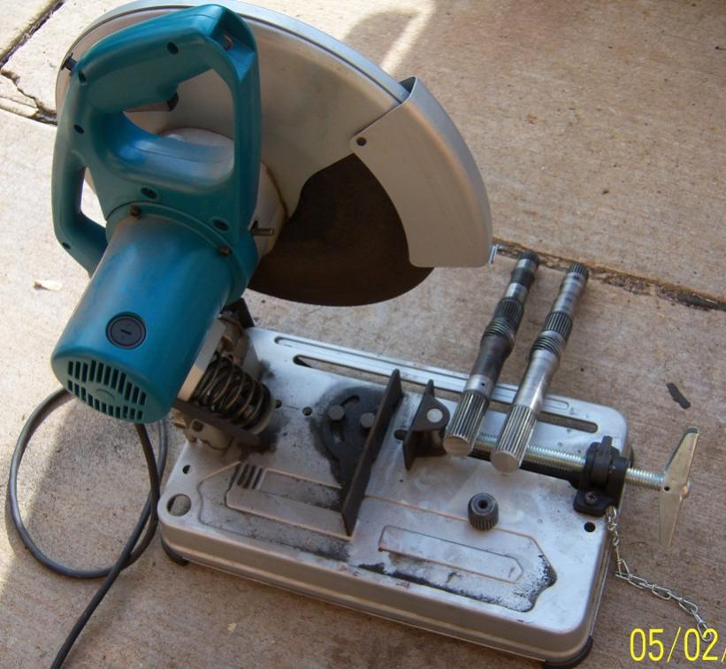

With my precision set of power tools..... :roflbow:
attachment.php
attachment.php
I was able to cut off the 2wd short output shaft, and make me another modified 4wd output shaft for the Th350 adapter. It doesn't look it in the angle of the pic, but rest assured, its cut square and is the exact same length.

As long as you went really slow and didn't overheat it, it should be fine. A wet saw is the best way to go. If the one you cut is the one on the left in the last pic, WOW it has some good, deep splines.
