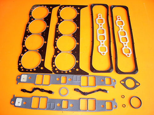

Ordered the head gasket set today.

not a bad price but I got a complete gasket set from northern for around that price for my 88 tbi.
I'll see if I can find the link.
Well northern doesn't have them anymore, it was a mr. gasket 7103 kit and was $30.99 for the set and like 10 shipping. Summit wants like $79 for the kit only.
