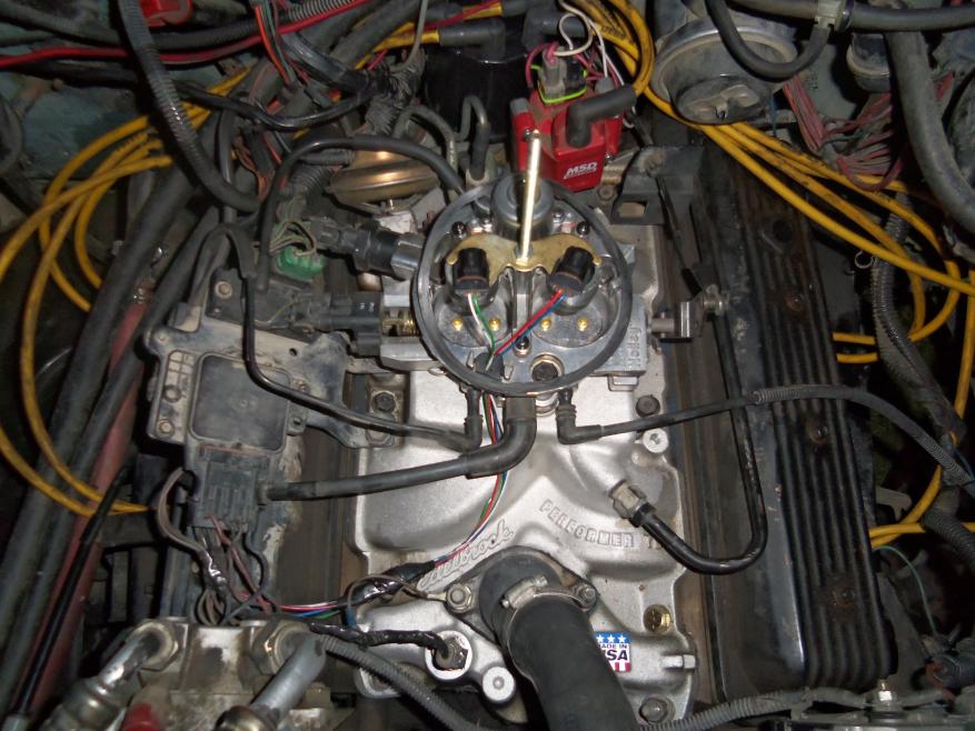

Yeah the knock has always been there but it was worse when the timing was advanced,,,,I couldnt get it to knock today but ill know for sure if its gone after i drive it for a while,,,,i thought it could be carbon build up maybe cuz of the gear ratio its always revving higher that it was intended,,,i dont know if higher rpms would cause more carbon or less build up though,,,,i did try diff gas for a while including higher octane but there was no change,,,it would knock with super in it as well,,,,

Yeah, well $10 for a can of seafoam, and it can be introduced through the throttle body...just foller the directions on the can, then let it sit for 20 minutes. It will smoke like a sunuvabitch when you fire it back up, but may help some.

IIRC, EGR failure and Carbon build up DO NOT cause knock. Carbon build up can be caused by knock, pre-ignition or detonation though.

The directions will say 1/3 of the can up a vac line and let it sit for 15-20, 1/3 in the crankcase, and 1/3 in the fuel tank. I've done half in the fuel tank, 1/2 up the vac line with good results. 1/3 may have worked too but I did half cans. Then I commonly do 1/2 can fuel tank, 1/2 can crankcase and don't do the sitting on the pistons. Keep the motor clean, you shouldn't have carbon build up and what little you will get, can get cleaned off through your fuel tank and driving it.

Carbon build up in the cylinders is what I is preachin...which could also be exaserbated by a weak or misfiring aftermarket coil.

I'll agree, the coil was PROBABLY the main source of the problem. MSD's are NOT POS's, it's just that HEI knows what it likes and neither MSD or Mallory either one of the Red guys are liked by HEI. I'm not certain on Accel though. I'm pretty sure I know of 2 guys running Accel, Coil, Cap, Rotor and Wires and they run good. Like stock, nothing impressive. Could done the same with OE parts.
