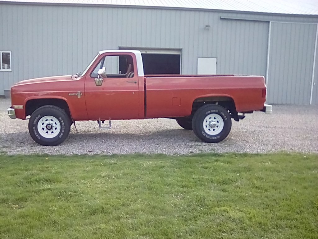

@Redfish Nothing beats original paint! And I think your truck looks awesome!
LOL..Josh I'll have to take some pics of my original white paint '84, your '85 looks so much better. Like a very well dressed, clean-cut N fit younger/shorter brother to mine.
I have different wheels, faded side trim, and chrome headlight surrounds w stainless center grille trim compared to yours but like the ways yours looks vs mine !!!

To me the size is perfect for it's stance, of course a 2" lift would require an inch taller tire..., and so on.., and so on......
