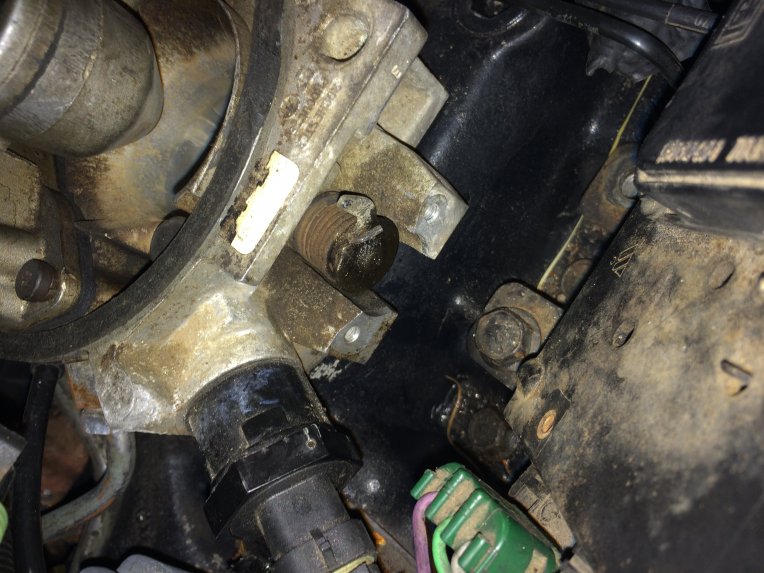

I'm having a similar problem on mine. It's not a constant high idle, though, and mine's a bit rich. Not horrible, though. Anyways, here's a picture of the IAC. It's the black thing on the left that can be removed with an adjustable wrench. My TPS is off in this picture so don't worry about that. I don't know what that tube is. Mine has the same setup minus the tube, and it it runs pretty good. Before you start thinking about the IAC, though, make sure you have no vacuum leaks, as that can cause a consistently higher idle, and for reference, can you see a screw on the driver's side front corner of the TBI, or is it smooth? There's a minimum idle air screw there that was sealed from a factory that many a ding **** crack open and play with.
Edit: The image uploaded on its side. The IAC is on the left of that green connector.

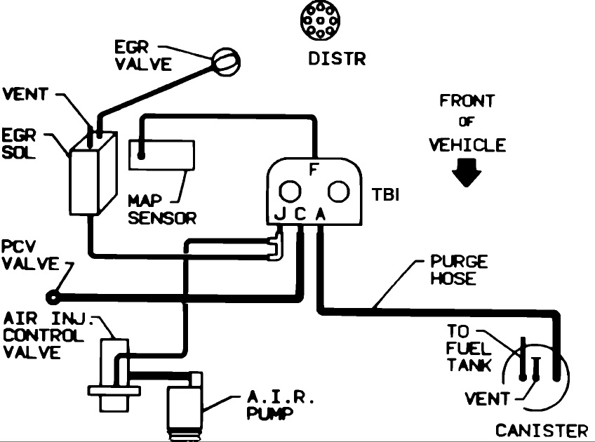

The catalyst sticker on the top middle of the core support is a good reference if you have it. It shows the whole vacuum network. Just make sure all the connections are tight according to that diagram. I think I have one in case yours is gone for some reason. People say that spraying carb cleaner or WD40 around the base of the TBI are good indicators of a failed TBI base gasket, which is arguably the most common vacuum leak. That's the best place to start. The screw tells you if someone's messed with the idle or tried to. If not, you don't have to go clean up someone's likely mistake.
