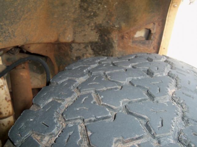

One thing about my K1500, since the day I got it, then installed the rebuilt Th350, this truck had drove smooth. Straight down the hwy at any speed, correct steering wheel spokes and no slop in the steering, so I've always considered the front end in good shape and in alignment. Also the tires are wearing very well and even with no cupping or innner/outer wear.
Today, I'm cruising along about 45-50mph, and all of a sudden the front end started shaking uncontrollably very bad. I actually thought I was about to lose a front wheel. I stopped right where I was at as far to the right as possible but there was no shoulder. I got under the front end looking for a bad tie rod or drag link, all looked good. All wheel studs looked tight, shook the tires what I could and seemed firm in place. Took off about 20mph and I can feel the front end wobbling badly. I went ahead and continued to the house about 20mph for the 4 miles I was from home, knowing if it came apart I could call one of my coworkers to tow it home for me. Just having a tooth pulled I just went in the house and laid down to get this bleeding to stop and didn't go jack up the truck to find out what was wrong.
Anyone have an idea of what I'm going to find wrong? Whatever it is, it's pretty bad. Honestly, I've never felt a front end come this loose before. Espeicailly on a truck that is normally just about as perfect as can be as far as steering, espeically for a 4x4 straight axle truck. I'm guessing maybe a hub bearing??? Both tires still seem to be standing straight up, or I would have just left it right there and called for the boss lady to bring me my roll back.
Any suggestions what to check for, what to suspect or a good guess will be appreciated.
