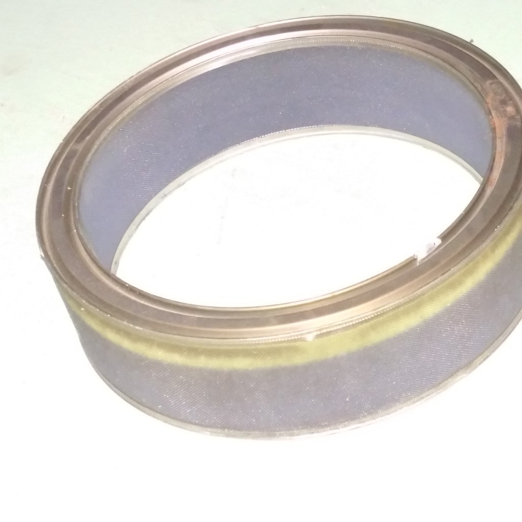

Hi, I am new to this forum. I have a 1982 Chevy G20 vans with a 350. I discovered the hard way that you want an air cleaner that has a blue/grey coloured ring which appears to be a carbon filled device which is permanently sealed into the air cleaner base. I removed mine as I thought this was a restriction to air flow (which it is) I soon discovered a problem though. My gas tank began to crumple as the vacuum from the fuel pump on a sealed system was not allowed to equalize. I replaced all kinds of things including the vapour canister and still had the problem until I realized that the grey restrictor ring that was originally in the air cleaner was there to provide a small area that was not under vacuum. This was how GM/Chevy had their system set up to be compliant to hydro carbons being contained. So if your vehicle is California compliant you may want to make sure the air cleaner you look for has this intact.

picture?

Yes the ring would look like this and would be inside of the filter and siliconed to the actual base of the air cleaner.

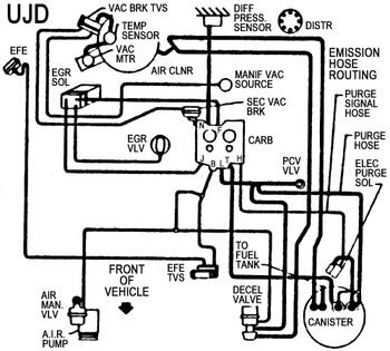

My 85 K30 (454) came with the taller air cleaner lid. I added it to my '79 K15 (350). It's 2" taller (5" air filter). The bases are the same. I took that air diffuser out of both bases without issue. I believe the metal ring attached to the base is actually for flame retarding in case of a back fire. HD trucks have a vacuum pod on the front of the driver's side of the carb (photo 3 &
1985 - 454
1979 - 350
4) that cracks the butterflies on deceleration at certain RPM's.

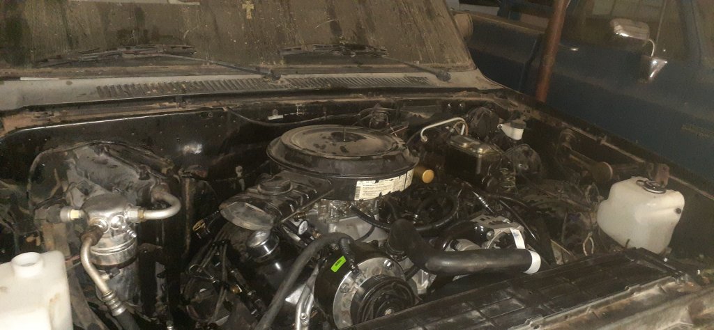

1985 K30. Regular leaded gas. I dont think that it has a charcoal cannister.

@VPC20HD here's my diagram. It's the factory one on my air cleaner base. Although it's for a 454, the color routing may help you.

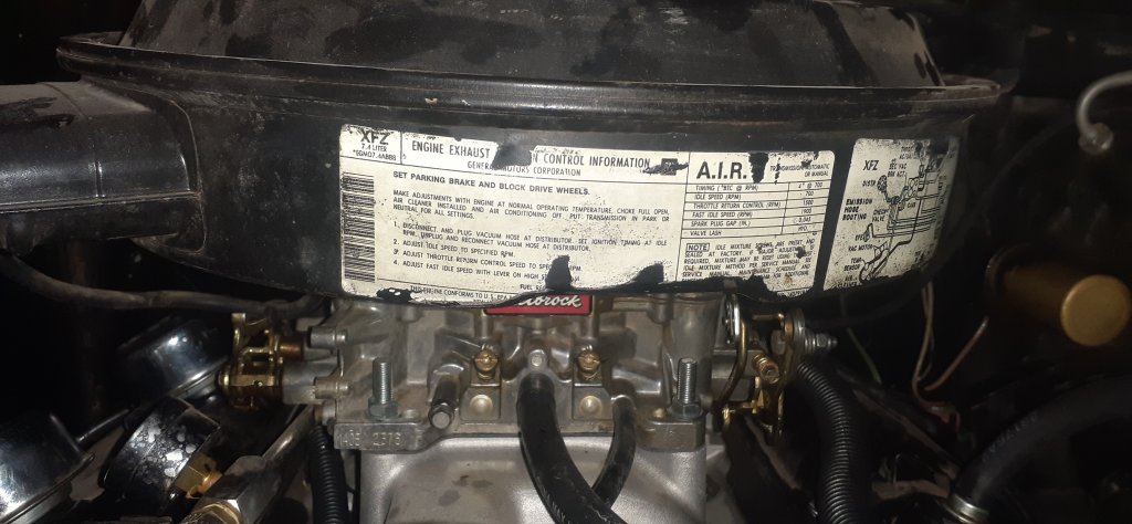

Hello,
I have a 1982 C20 HD and I'm missing the original Air Cleaner. My dad was the first owner and bought the C20 in California and after doing some research, I believe there was an emission label on the Air Cleaner with a CNU emission code label. My C20 is "M code" which means it has a LT9 engine for HD pick ups. My questions is, Can I put on any Air Cleaner that was on a LT9 or LS9 engine from 81-86 or Do I have to find an Air Cleaner that was just for the LT9 engine like the one I have.
Any info would be appreciated, Thank You.
For legality and emissions you need an original air cleaner,non HD the emissions label was different and on the radiator support because the vehicle was certified. HD the engine was certified so the emissions label was on the air cleaner. No sticker anywhere will be a redflag and technically a fail.
