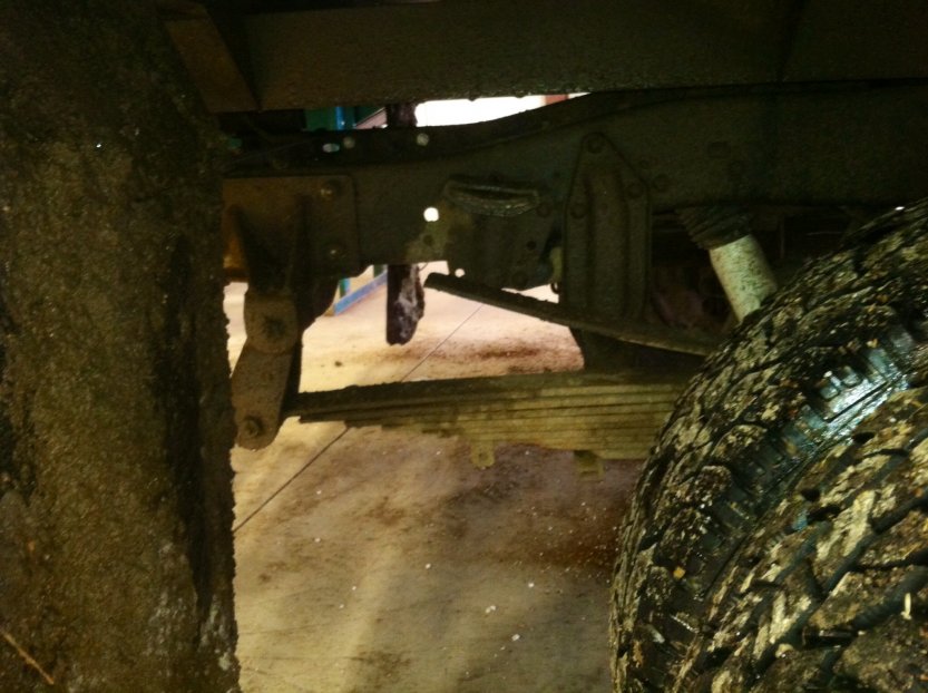

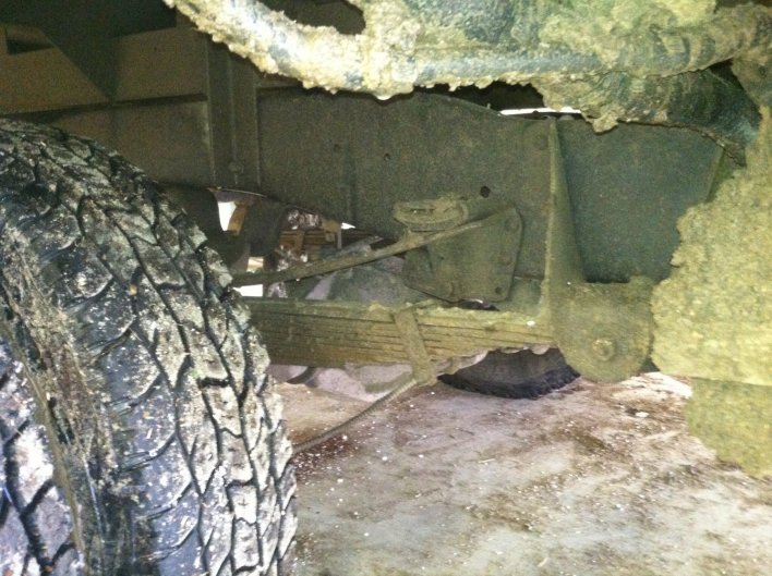

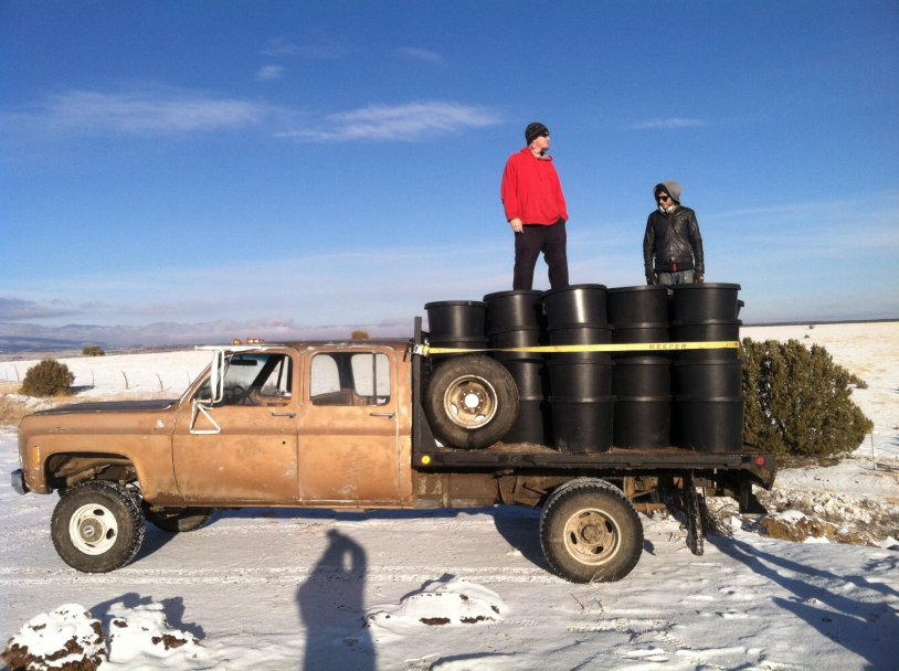

Too much work haven't had time to wrench, been drivin the ol crewcab everyday. Have plans to put him in the shop for front brake work this week. Pretty sure it's rotor runout or sticky caliper causing the wobble now. Only shakes when braking. Found a place to rebuild steering box for $100 and rebuild power steering pump for $50. That'll be next. Been hauling 25 gallon pots with roots & dirt at around 60-80 lbs each, fit close to 80 pots each load. After the rear shackle flip the rear overload bump stop is 2.5" too far from the overload spring when the truck is loaded. Anyone flip this bump stop to mimic the shakle flip? Also considering an airless airbag setup like sumo springs to help eliminate body roll and add support for heavy loads

Front hanger of rear leaf spring when loaded

Rear hanger of rear leaf when loaded

No experience with them, but they seem like glorified bump stops. I think you could get the same results just be relocating your rear overload brackets, and maybe adding another leaf to the overload if you still need a little more stabilization.
