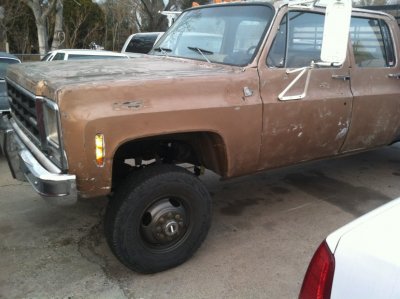

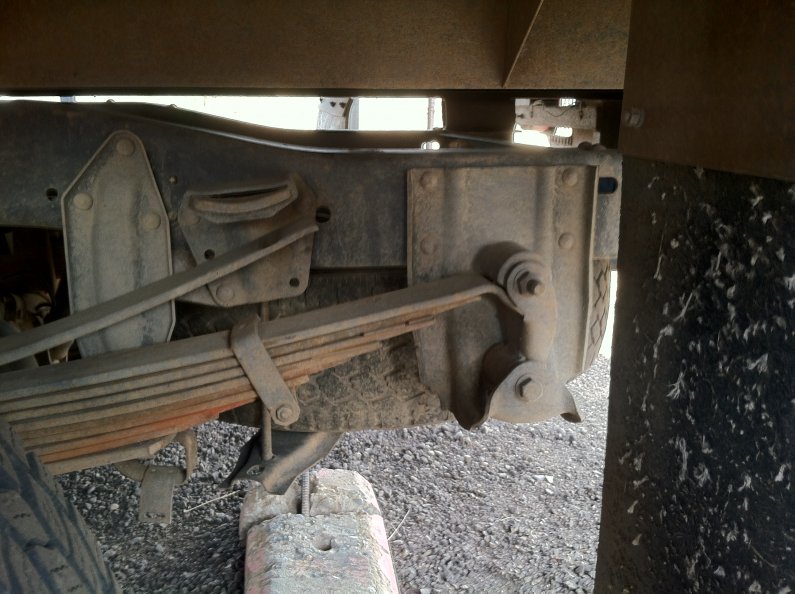

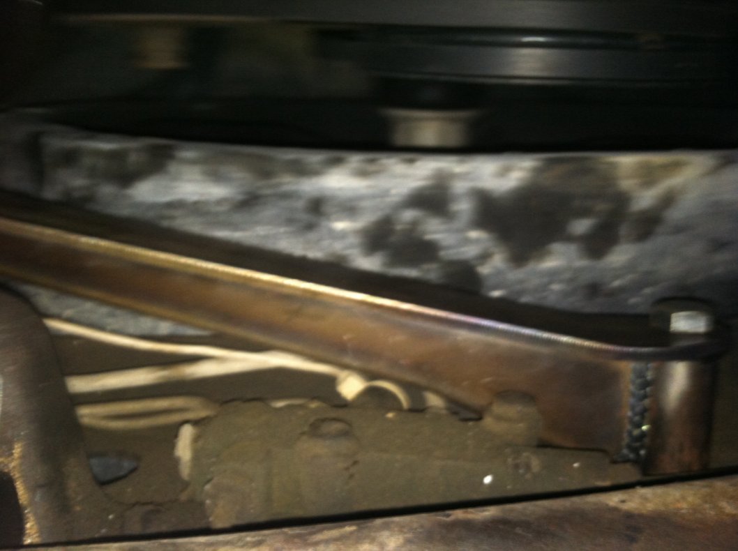

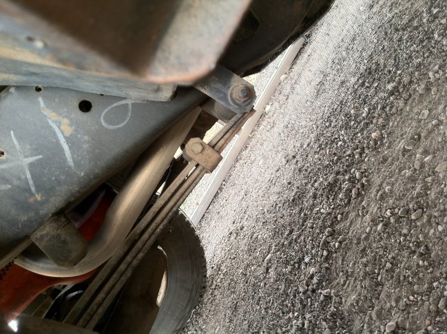

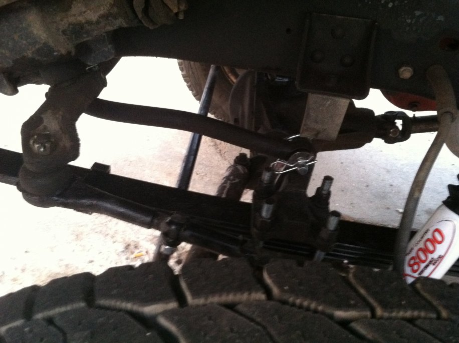

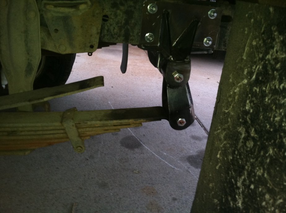

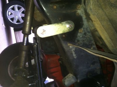

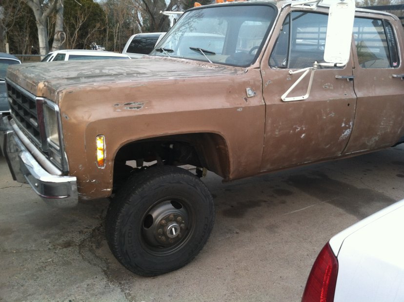

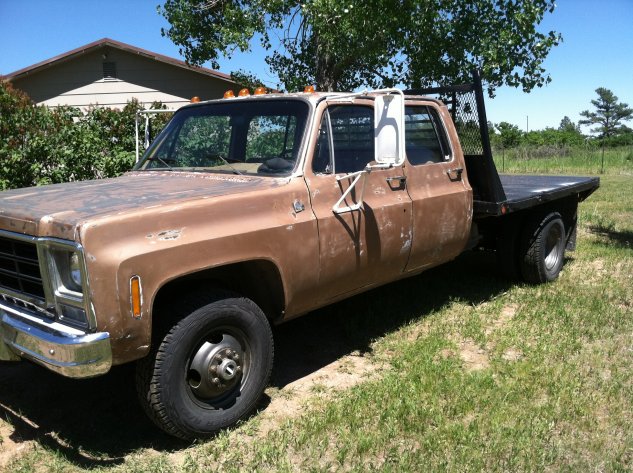

got all the new parts installed. didnt realize i would have to relocate the spare tire but ill mount it to the flat bed somewhere, for now its in the back seat. dropped the truck off friday at the alignment shop, hopefully done today. heres a few pics.... before n after

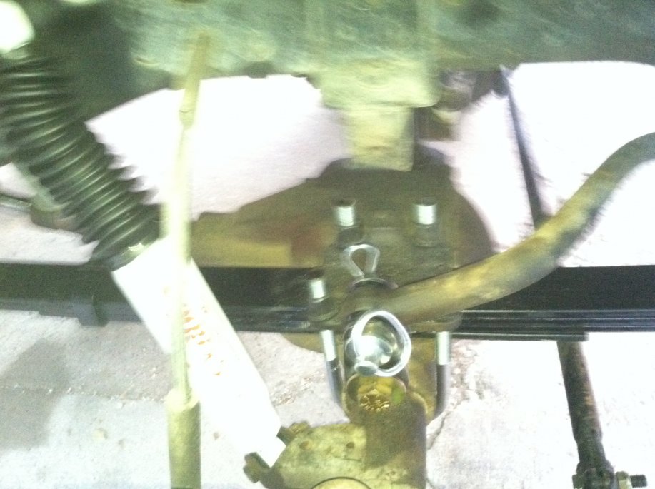

moar pics
