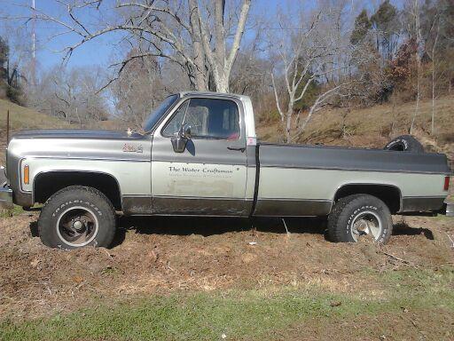

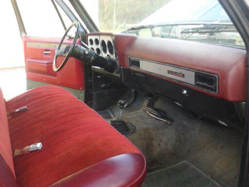

Well, I've finally found the perfect candidate for re-creating my first truck. My real first truck was a '79 GMC Heavy Half LWB 2WD Olds 350 Diesel, which had been converted to a Olds 350R gasser. Two tone grey over red(or burgundy?) interior. My dad bought it new when I was 1 and sold it when i was 16 to get an '89 that i flogged for a few years. I only had the old gray mare (as my brother called it) for a few months before "big red" was finished and delivered, but having grown up with that truck I have always wanted to find it again.
The truck I've found to start with has the correct paint job, is 4wd (full time - any comments?) like i always wish mine were and has most of the interior there, but not in great shape. I can find almost everything to rebuild the interior at LMC - BUT - is the "red" that they offer the factory color from '79 or were there multiple choices in the "red" camp? Unfortunately I don't have any pictures of the insides of that old truck.
If there were both red and burgundy available - does anyone have a source for the factory colors other than those offered at LMC?

Well, the shades of red changed a little over the years. But generally the late 70's interiors were "Carmine" or "Dark Carmine" where the LMC replacements are just a generic red color. Some of the higher end restoration companies offer parts in a few different shades of red so you can get something close to stock.
The truck in the pic has a recovered seat and 80's model door panels. The dash will be a slightly faded but correct red color like original.

Yes, i know the door panels are all wrong. The current owner keeps telling me that there was an "off-frame" (his words) restoration about 10 years ago. I guess "restoration" means different things in his circles.
Getting the door panels back to '79 correct is going to be a pain (lots of bits of trim) but it will be worth it.
Can you share the name of some of those companies with factory correct interior bits? I thought the LMC red was a little bright.

Classic Parts sells a vinyl Upholstery dye in Carmine Red. They cost $17.95. LMC, on the other hand, has a can of ColorBond vinyl paint that cost 14.95. The one in Classic Parts advertises it as Carmine Red, which is the original factory red. LMC has burgundy and red.. And in the catalog, the red looks like the OEM dark red. Up to you, I suppose. I, myself, am looking for some door panels that are dark red, because mine are faded and flaking pretty bad.

There's a few companies and I can never think of them all at once. Classic Industries and Brother's come to mind.
When I did the '77 dash and door panels, I used SEM plastic and vinyl paint. I used two different shades (I can't remember the names, but I still have the cans), one shade for the dash and the other for the door panels. The factory panels were never perfectly matched and I wanted to duplicate that.
