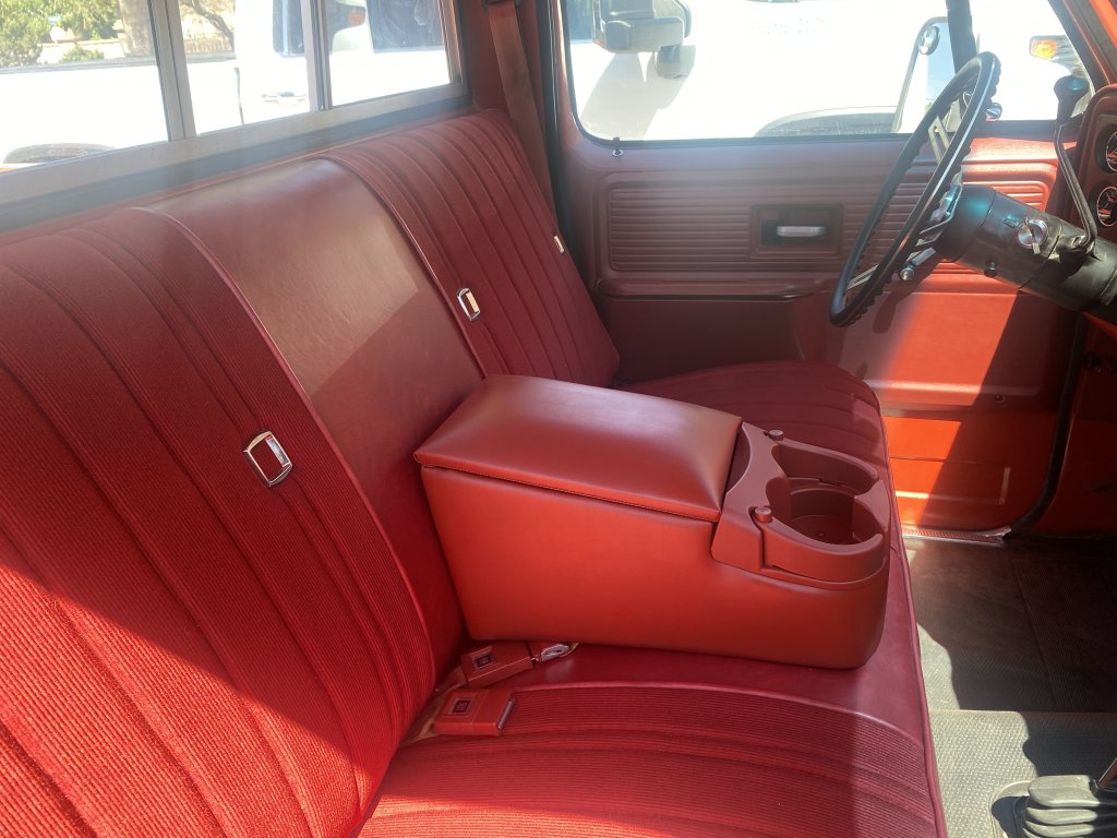

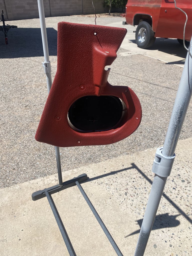

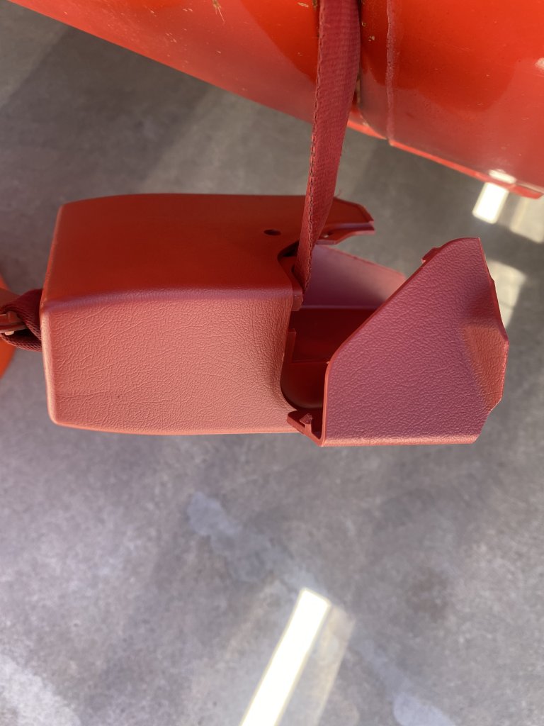

I replaced my door panels from LMC but everything else I used SEM paint and just prep’d everything really good and have not had any issues. Wanted a cheap console/armrest so found one at Tractor Supply that was gray and painted to match. I used Firethorn Red.
