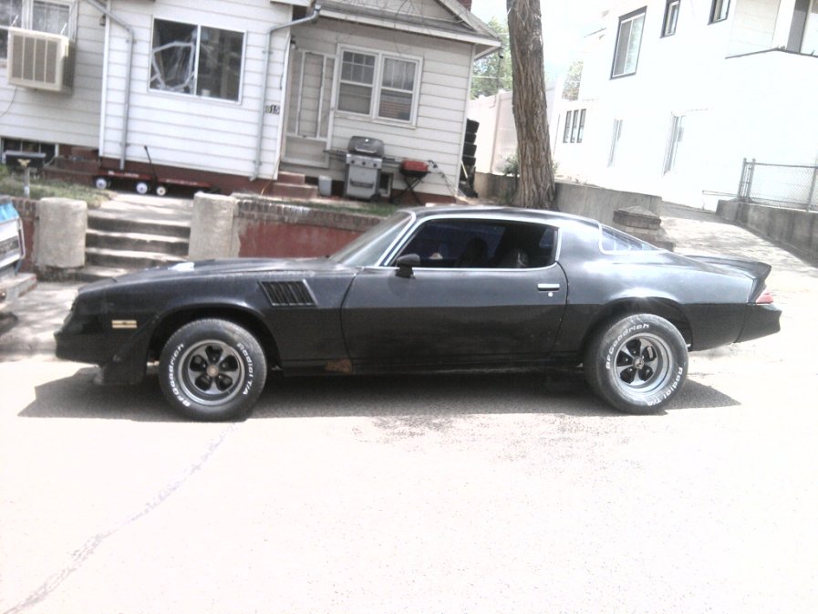

here's my newest project, a 79 camaro that turned out to be an rs. I had 2 build sheets in the glove box for it and found another on the gas tank. I've wanted a late 2nd gen f body for over 15 yrs and finally got one, traded my old 88 4wd for it. I got it in june 2015. The only real things I've done to it was emove what I didn't want or need and sell. It has a bad frame rail in back rest is pretty solid, each lower front fender behind the tire has a small hole I have to cut out and patch. Plans for now are just get it in my garage, tear it down, epoxy prime everything, most likely remove and paint it all, rear end, susp. etc. I have the dark blue metallic from the truck we're going to use unless plans change lol. I also have to get tons of interior pieces, these are all brittle. We plan to do all black inside.
These were the pics from the PO.

I took these after getting it home and cleaning it up on th eoutside...

I already got some new stuff for it, I bought all the z28 side flares and lower chin spoiler, also some fender vents that are 80/81 style just one slit, might get the older style louvers, wife likes them better. Some say it's a z28 clone because of that, I don't I just like the flares and vents, not trying to pawn it off as a z28, just building it for me how I like. I bought a set of older chrome long tubes, they are already on it, exhaust I went with a jegs 2.5 x pipe with cut outs, some thrush welded mufflers for now, and will get taillpipes later. I'm thinking of getting antique plates for it and have it that way to avoid annual inspections and more free play in exhaust setup and window tint etc. The car has no brakes, I ordered a new master cylinder and prop. valve, have to get all new lines and the rest of the brakes, of course new steering and such as well. The car has been off the road since 93 due to brakes, it fired right up no smoke no knocks nothing, but carb was a rebuilt quadrajet that was leaking around the accelerator pump so I put on my edelbrock for now.
