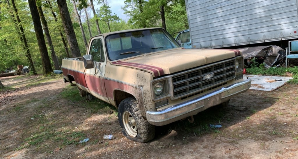

You see id do the suburban tank but I have a utility bed on the truck so that’s not an option. But the passenger side only tank is gonna take getting used to and as it being a work truck I’d like to have to get fuel the least amount possible.

Here’s some photos since I don’t think I’ve ever shown this truck on here.
