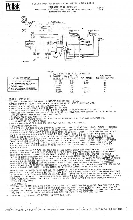

Hopefully your wiring is still in place. The switches are available on LMC. Just make sure you get the right year. If they left the wiring for the pollak valve you are in good shape. Put up two new tanks while you are there. It’s like an extra $100 each side. Also, Pro-tip; extend the fuel, vent and return lines between the sending unit and the steel line by about a foot get the clamps on them nice and perfect and let it curl up on top of the tank. Don’t try and get those three inch hose back on their. I have heard the fill hoses are a little hard to find.
