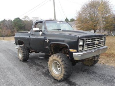

here she is! traded MY 1986 honda 250r for this!

nice trade, good looking truck cowl hood and all, lifted short bed, awesome deal IMO.
