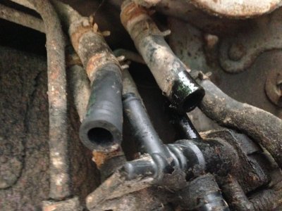

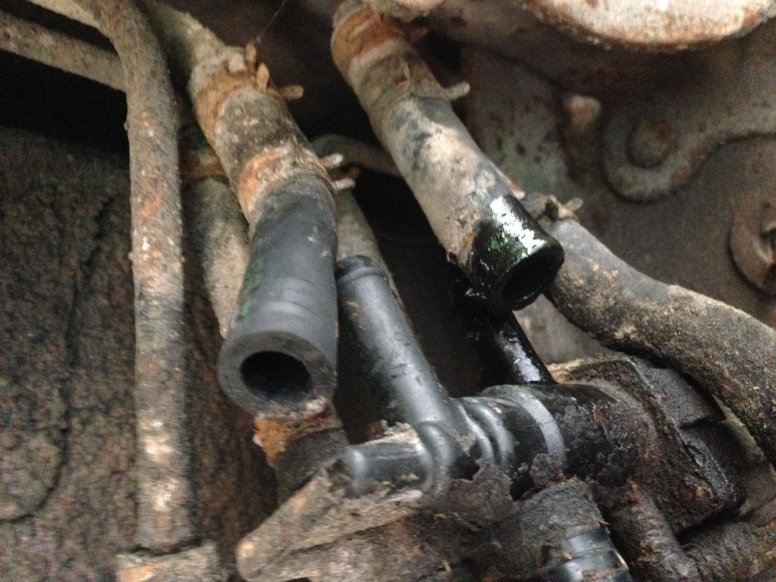

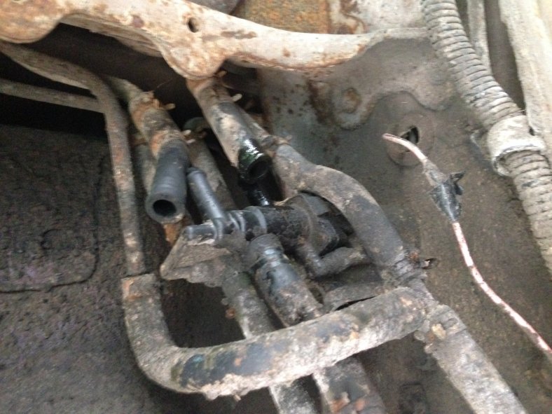

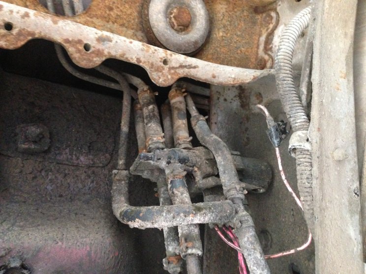

I took these pictures while I was changing my selector out. I haven't finished because I need a smaller hose for one of the lines because it leaks even with a clamp. :whymewhyme: You should be able to see which hoses go where though.

Those pics should be inverted. The bottom two lines go toward the engine. Top right two lines are passenger tank, top left two are driver tank, T line is vapor with the line disappearing into bottom of pic heading toward engine where the vapor canister is.
If that makes any sense, he is laying on his back with his feet toward the engine.
1984K10
Nov 7, 2013
110
Baytown, Tx
Cristian
5.7 (350CID)
Yeah I was actually laying with my feet out of the side but for some reason the computer switched the orientation as if I had my feet towards the engine
