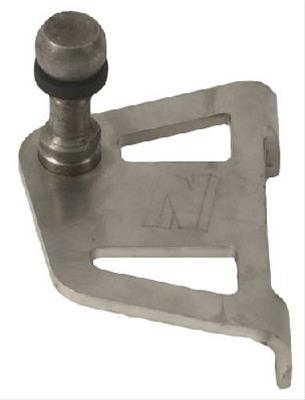

Nice to see you’re going manual on the LS. Do you need an adapter for it? Mine is 2wd so not familiar with the sm465. Depending on how the LS mounts you may need to move the trans position and change out driveshaft lengths. Are you keeping the mechanical clutch? I went hydraulic but if you stay me ha I am you’ll need that pivot ball in a specific location on the block for the z bar.

Sorry for late replies, I worked all weekend. I plan on trying to get a barb the correct size a clamp it in a piece of hose at the heater core spot on radiator. I did have intentions of keeping the mechanical clutch so atleast something would still be simple hopefully I never thought about the pivot ball on the block, is there anyway to retain the mechanical clutch?

Full disclosure I went hydraulic clutch and am running an NV3500, so I can't definitively tell you exactly what you need. The only reason I brought it up is because when I was doing my research on keeping a mechanical clutch and a 4 speed linked with an LS, it would require adapters. I've seen the pivot ball for sale on a few websites....here is the link to what summit is peddling:

Gotcha, I ordered a clutch pivot ball bracket from kegs and a steam port kit with two pieces, a line connecting them and a barb to send a hose to the rad.
