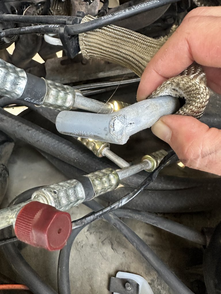

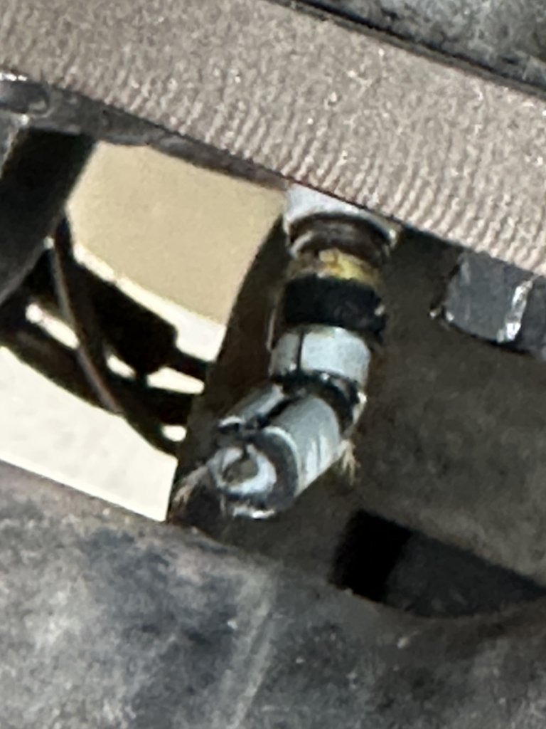

Found the issue. Shudder is most likely a burnt plug wire and dead cylinder:

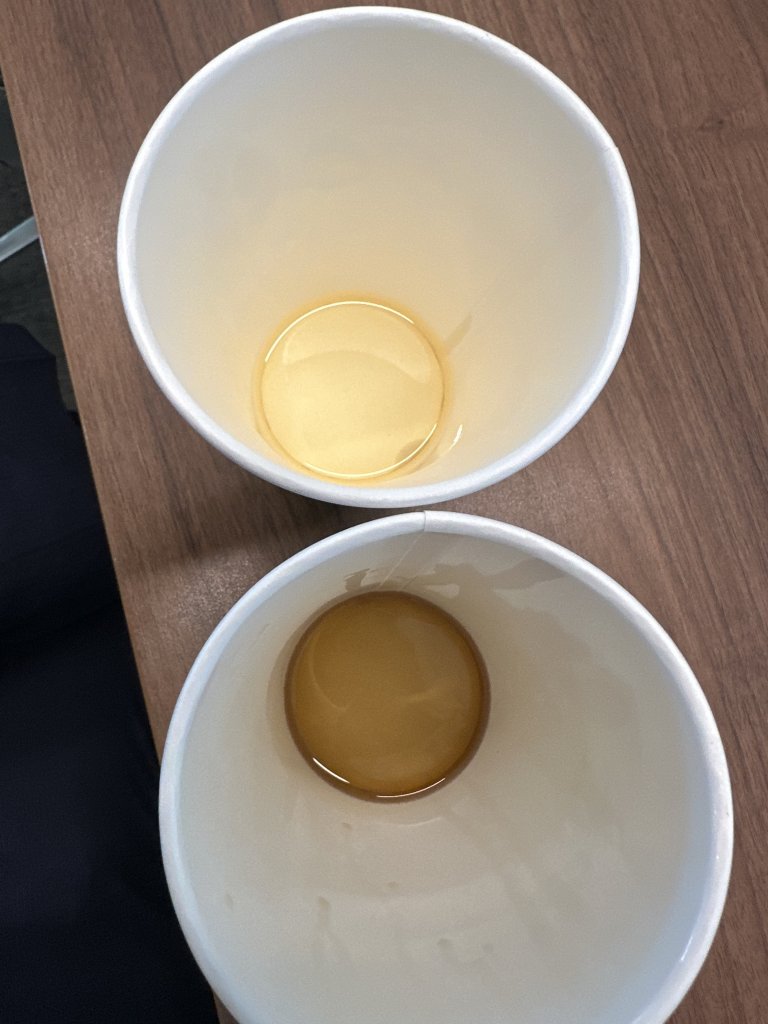

Nick,
What do you think of the fluid color after 800 miles? Looks pretty dark brown to me (new fluid is on top).
We are still battling 200 degrees at highway cruise with the trans temp. Dual cooler setup (radiator through to Derale aux cooler with fan.)

@txaggie - maybe it's the lighting in your photos but the top cup looks like it has some fresh 5W-30 while the bottom looks like 5W-30 with some miles on it.
If that is trans fluid after only 800 miles, Id be a bit concerned...Any driveability symptoms?
