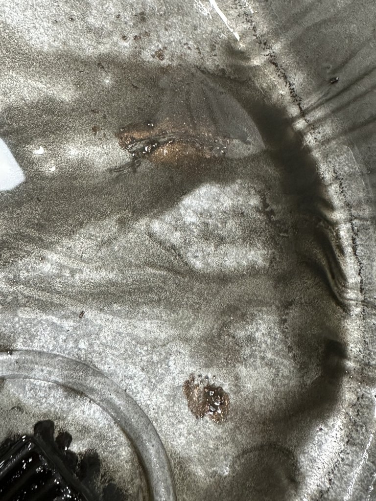

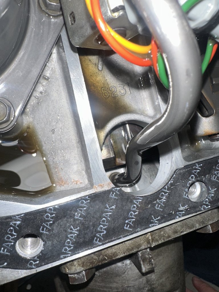

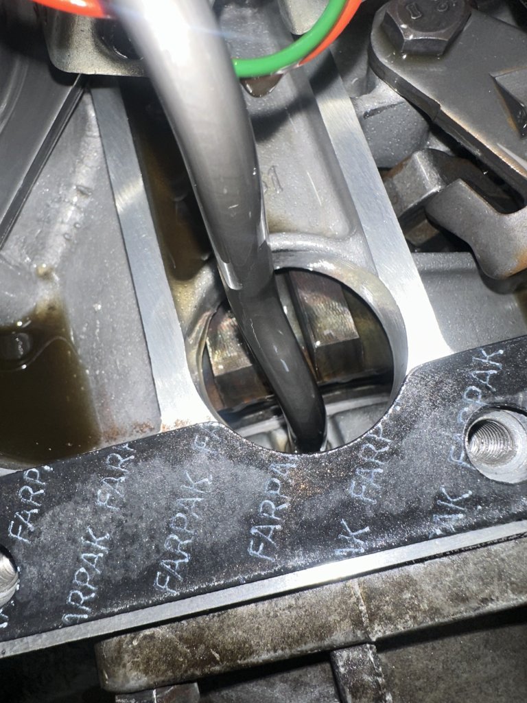

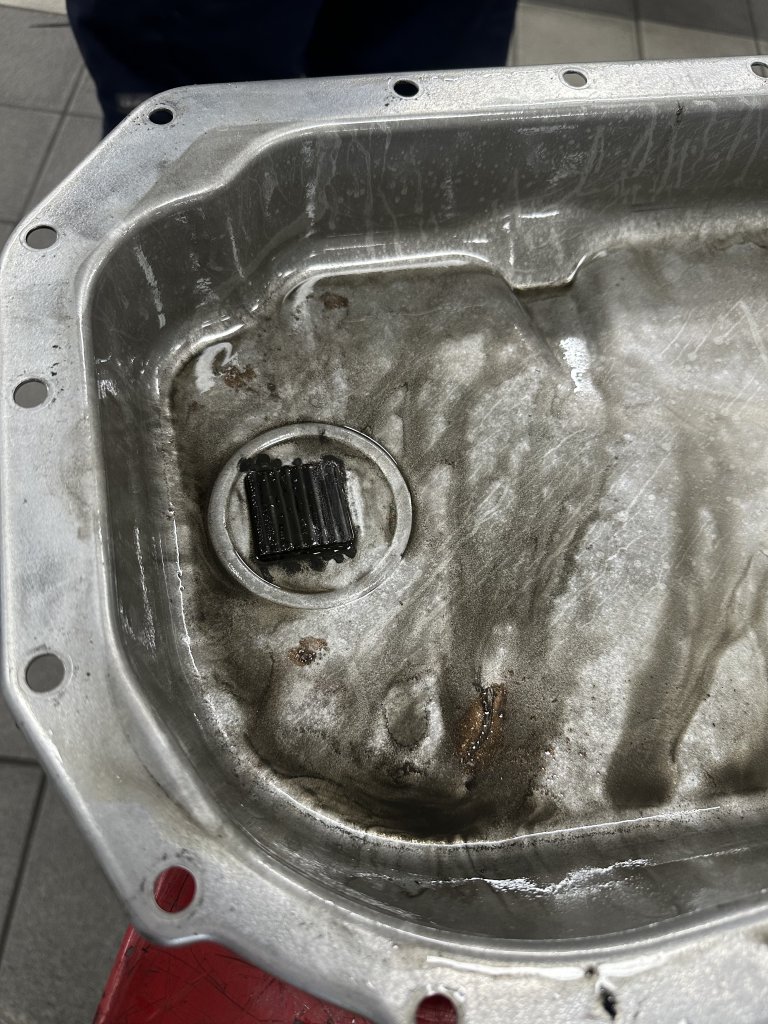

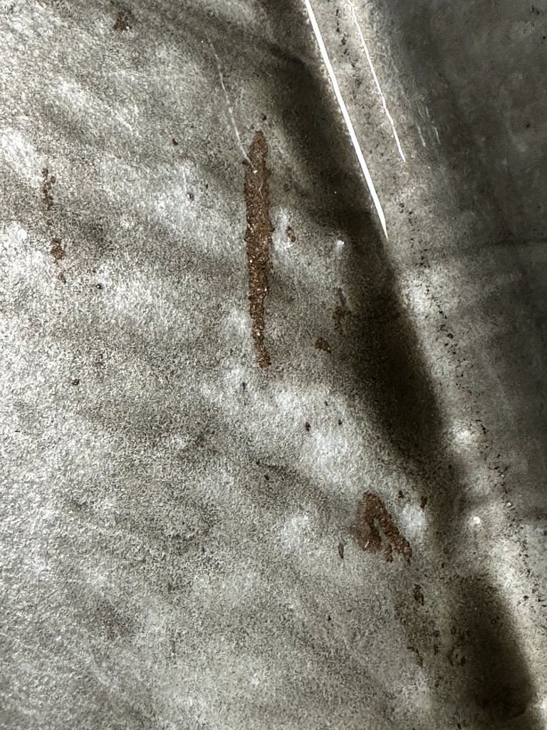

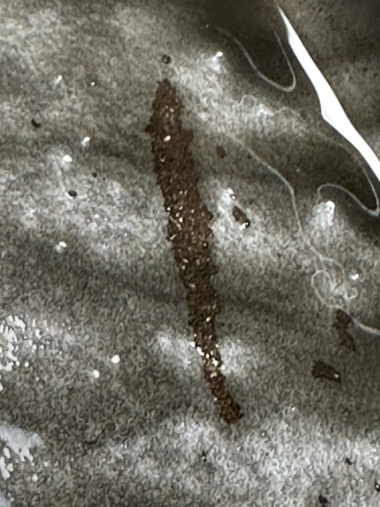

Here is what the pan looks likes. There are some strips of bronze material. I’m assuming this is bushing or bearing material? At the time of install, I had a false scare where we tought the torque converter might be bad due to shuttering but it was a burnt plug wire. He is claiming that the misfire and shutter feel caused damage. Could the bronze material be converter material? Temps only got up to 215.
I'm no builder... but that looks like a **** trans build to me.

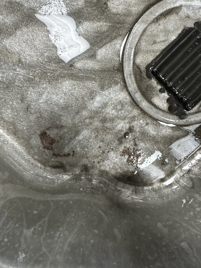

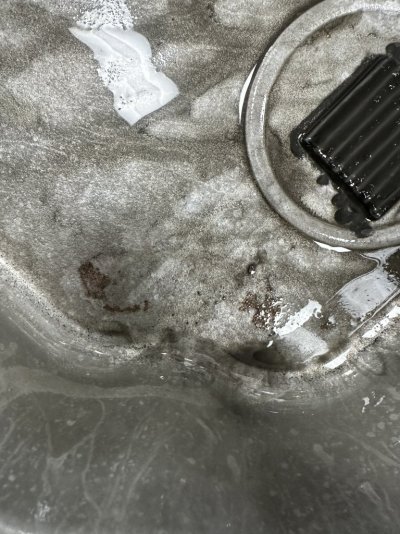

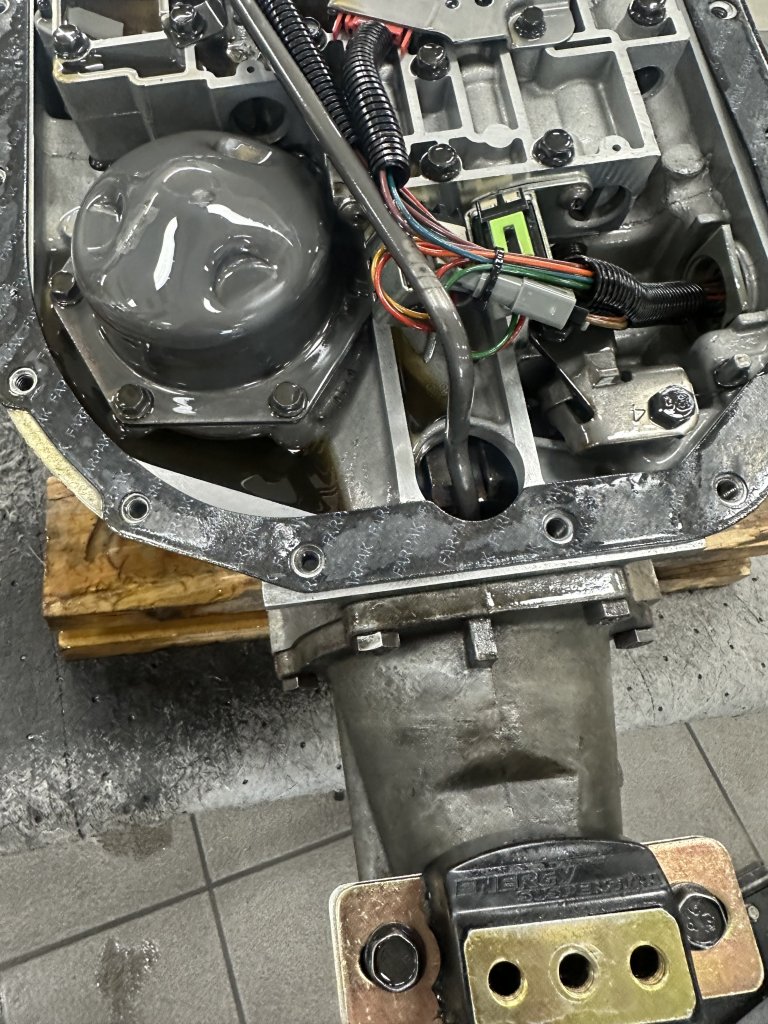

What year is the 4L80? If it's a 97+, did you use the correct rear cooler line fitting?
Misfires can definitely damage the TC and input shaft splines, depending on how long it was driven with the misfire condition, severity of the condition, etc.
Trans will need to be completely torn down as if it was a new job, everything inspected, tested and, where applicable, reconditioned or replaced. TC failures like that are generally catastrophic insofar as LOE to restore the trans to new build condition again as the pump's working surfaces often sustain damage and need re-machining or replacement.
Let us know what happens once the builder has it and gets back to you...

I drove the truck for 5-10 min at lower speeds with the burnt plug wire. Once we remedied the plug wire, I drove the truck another 800 miles and only monitored the trans temp (200 at highway speeds) after driving an hour. Curious to see how much damage is there. Being that we pulled the motor I thought it might be worth while to open the trans pan.

Tore the trans down with the builder. All bushings look perfect so the bronze most likely came from the converter. Some of the forward clutches were a bit burned too. All other things looked good. I explained that my third gear felt too soft and the builder thinks our shift point was too low on the Holley programmer.
